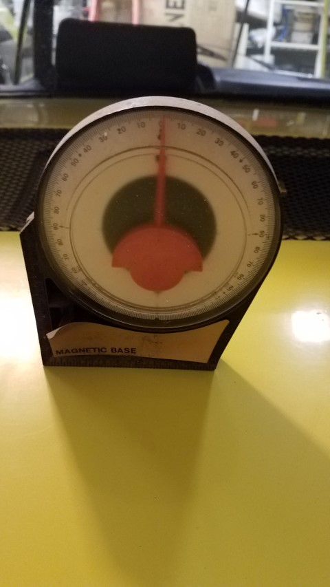

It looks like the hex bar is adjusted all to way to one side for some reason. The pivots for the hex bar that hold tension on the springs are adjustable. In one of the photos the pivot is almost all the way inside the hex bar and in the other photo the pivot is adjusted most of the way out.
The angles you have highlighted in green are pretty much fixed. The angle from side to side is the angle that you want to make sure is symmetrical. If one of those bars has a different angle than the other the carbs aren't going to open in unison. I have a cheap magnetic base angle finder/gauge from Harbor Freight that I used when I set my carbs up that helped me get it right.

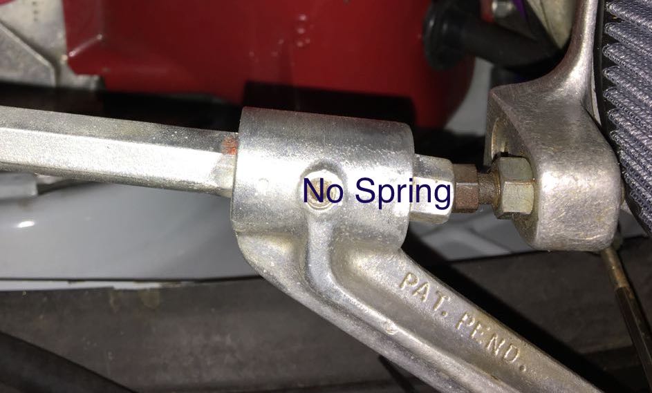

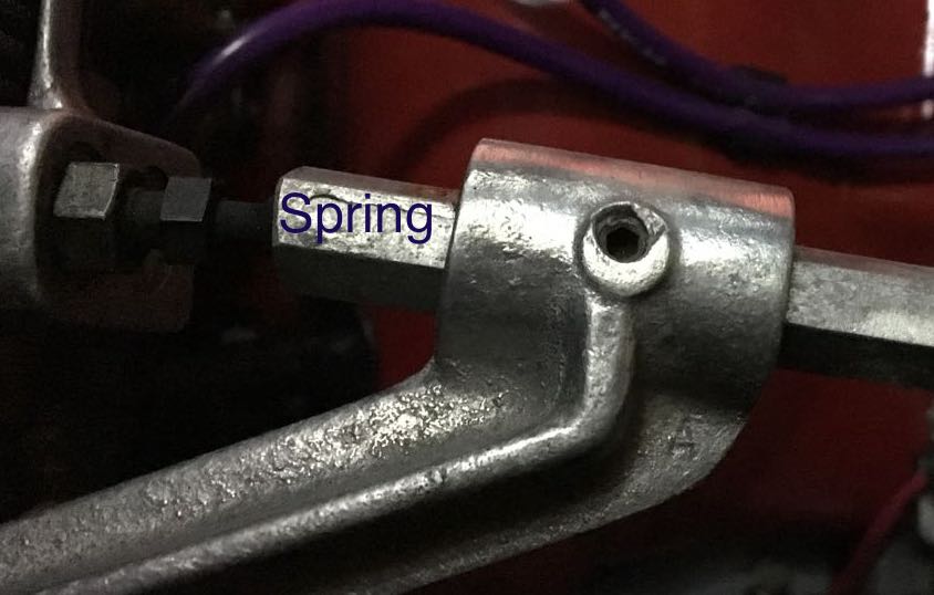

QUOTE(MarkV @ Dec 25 2017, 09:44 PM) *
Tonight I didn't detect a spring on the right side of the hex bar, only on the left.
I'm 60% sure I understood the part about angle from side to side, but I'm spacially challenged so please bear with me as I confirm: the angles of the two linkage rods (the funny-threaded rods with heim joints at each end) against the carbs when viewed from above the engine lid?

MarkV   There are two angles to check. There is a front to...   Dec 26 2017, 12:25 AM
MarkV   Here is a photo from directly above. See how there...   Dec 26 2017, 12:40 AM
rhodyguy   The CB linkage should be spring loaded on both sid...   Dec 26 2017, 08:18 AM
