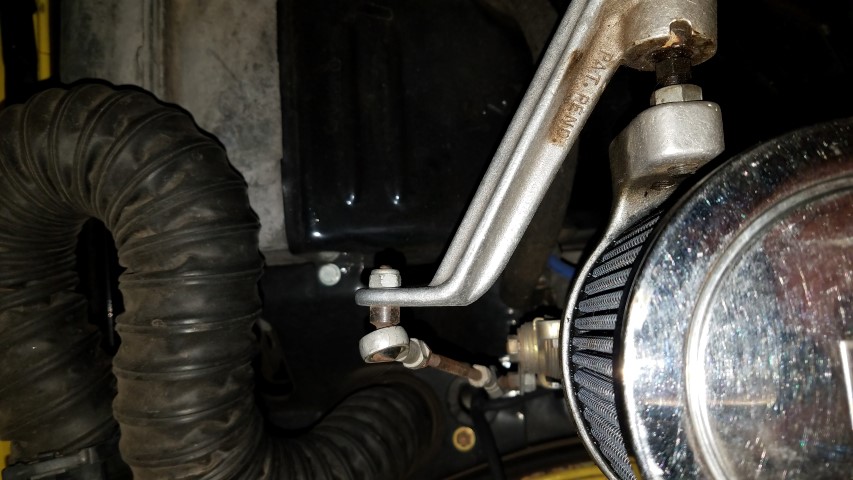

I suddenly find myself owning 1970 4-cylinder 2.4 with Web hot street Cam idles nicely and pulls hard at WOT. Part throttle response is not great, often with carbs coughing and even backfiring on trailing throttle. My use is mostly street, so I'd like to get this part throttle stuff sorted.
Here's pictures of the stuff that's in there now. I guess that's the infamous Bosch 009 with no vacuum advance and a PerTronix 1847A. The carbs are Dellorto DRLA 45s with short velocity stacks and these tall foam things that don't seal against the air cleaner housings. I'm willing to learn about the carbs but I don't have much confidence in the 009 for running nicely on the street. Please correct me if I'm wrong about any of this stuff.
Also from other threads I gather that switching to EFI such as MicroSquirt would cost $5K or so ... though I'm not ruling this out completely. Correct me if I'm wrong about that.
Is this kind of linkage OK?

Here is a photo from directly above. See how there is an angle from the pivot arm to the carb? The pivot on the pivot arm is closer to the center of the photo than the pivot on the carb. One is not directly over the other....that angle need to match on both carbs. The pivot arm is more inboard than the pivot on the carb.

MarkV   There are two angles to check. There is a front to...   Dec 26 2017, 12:25 AM
MarkV   Here is a photo from directly above. See how there...   Dec 26 2017, 12:40 AM
