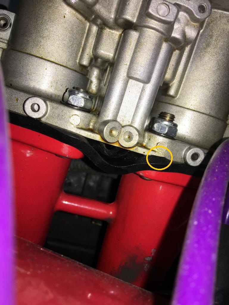

From what I can see in post #43 the thick intake gasket is deformed and leaking air. It looks to me like you can see the inner edge of the gasket has been squeezed out. The carbs will never sync up if you have a big intake gasket leak.
Ditch the hex cross bar and get a CSP bellcrank. I found a CSP type 4 kit at Mid-America Motorworks for $125, even if you paid another $50 it's worth it. Think of the CB cast hex bar as a linkage from a Yugo, and the CSP as from a Porsche. There's that much of a difference. https://www.csp-shop.com/en/engine/type-4-b...ida-23951b.html

98101   I hope another newbie question is appropriate. I ...   Dec 16 2017, 05:04 PM
rhodyguy   I've never seen one like that. Neoprene? If yo...   Dec 17 2017, 01:42 PM
porschetub   Holy cr#p never seen base caskets like that,WAY to...   Dec 17 2017, 02:38 PM
rhodyguy   One thing at a time. Any VW/bug shop in the Seat...   Dec 17 2017, 03:38 PM
Mark Henry   IIRC those are CB performance gaskets, I think the...   Dec 17 2017, 03:55 PM
MarkV   My carbs had some thick gaskets somewhat similar t...   Dec 17 2017, 03:58 PM
Mark Henry   Just googled I was thinking dellorto "Jet Doc...   Dec 17 2017, 04:06 PM
98101   Just googled I was thinking dellorto "Jet Do...   Dec 17 2017, 05:01 PM

type2man   Looks like you have the dellorto upgrade kit becau...   Dec 17 2017, 07:00 PM
rhodyguy   I don't get how it could bow down that much.   Dec 17 2017, 07:07 PM
98101   So the gaskets weren't leaking (at least at id...   Dec 23 2017, 03:54 PM
