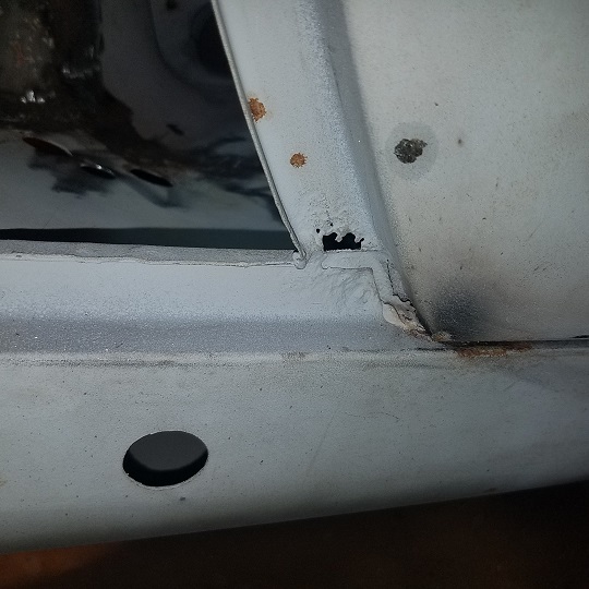

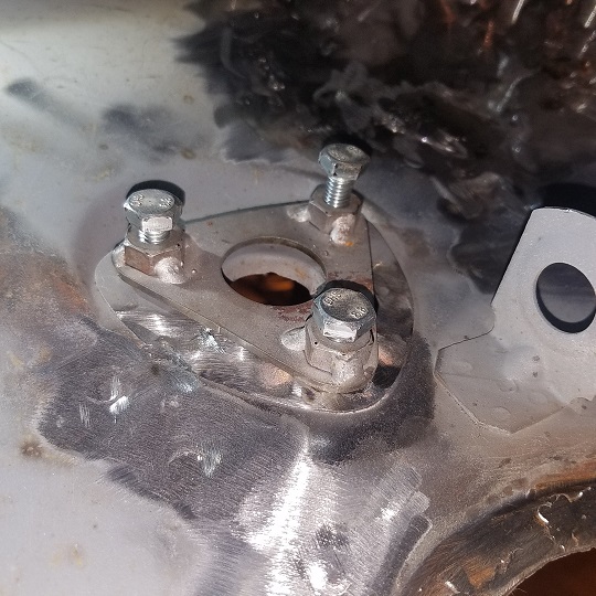

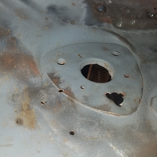

After a little more inspecting ..................
I found the left front sway bar mount is missing a nut and torn. (IMG:style_emoticons/default/mad.gif)
Used my Tangerine backing plate to center it up and weld on an 8mm flange nut to
put it back in business.

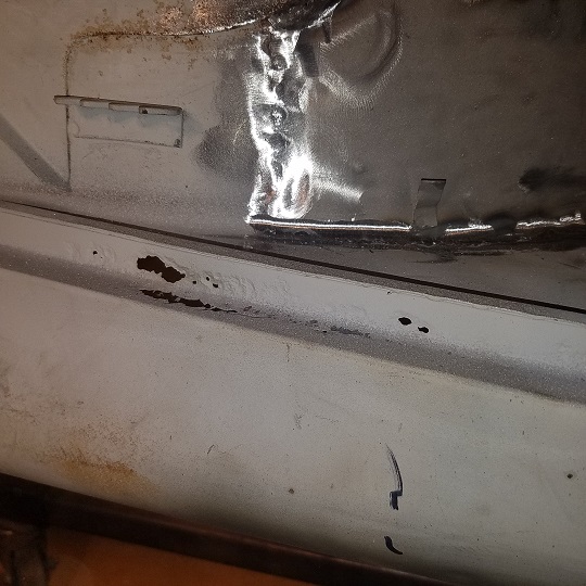

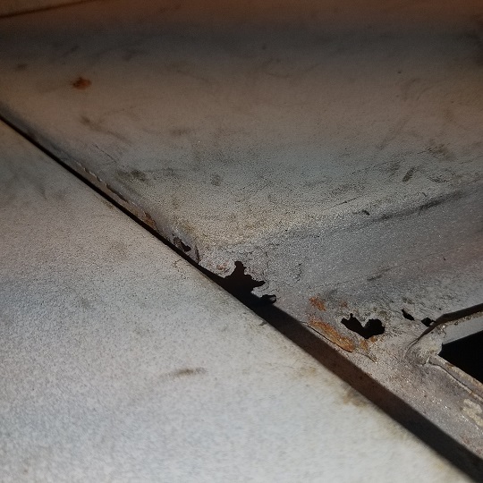

Then it was time to take a look at the front trunk channel.
I'll probably move this repair to a separate thread because I'll be using the 914 Rubber's weatherstripping channel repair strips.
