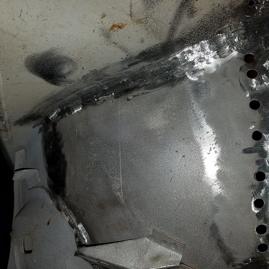

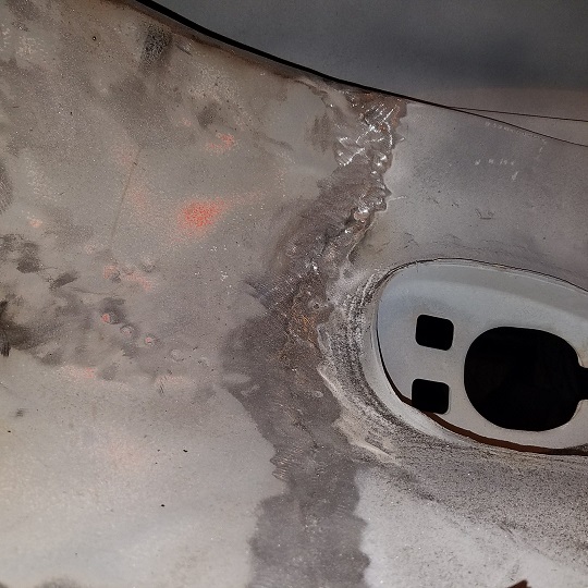

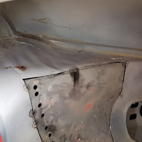

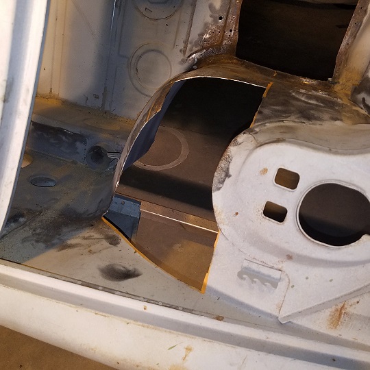

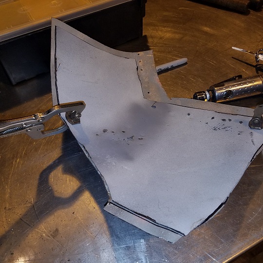

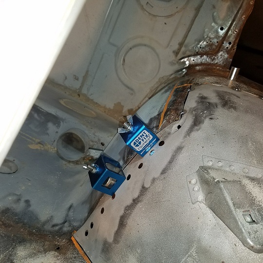

Got all bundled up and got back to work. Still 40 degrees ...............
Out came the right fender..............
Trimmed off the excess on the new patch piece. Then clamped it up and cut out the patch to fit.
Got a nice tight fit on the patch. I was thinking that I made the patch too big. But I still ran into some thin spots along the seam. (IMG:style_emoticons/default/sad.gif)
Let the fun begin ..................
Welding was pretty uneventful ............ other than the thin spots I'll need to tackle in the morning.
I love my MillerMatic 141 .................... (IMG:style_emoticons/default/welder.gif)
