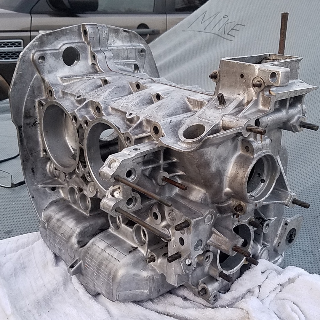

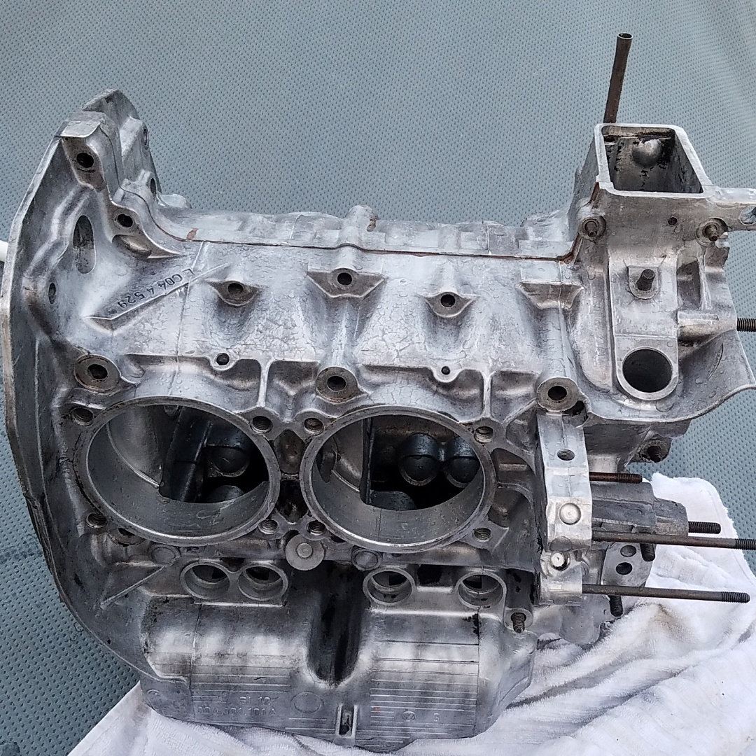

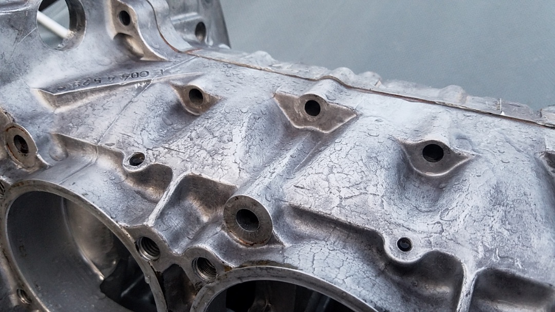

Cleaned my engine, also deburred it a little bit also by cleaning up the extra aluminum from the casting process. Not as sharp now.
Cleaned it using my pressure washer with media blaster attachment with baking soda.
