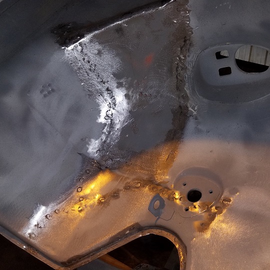

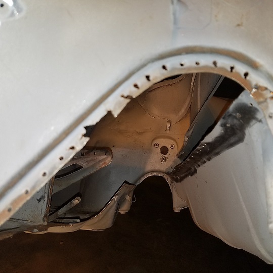

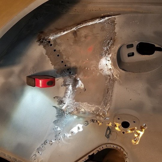

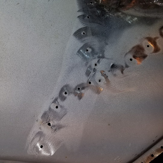

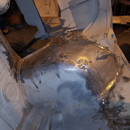

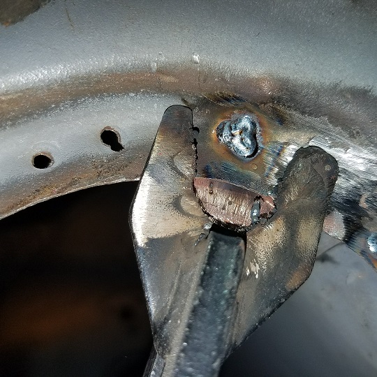

Started with tidying up the thin spots created by the round material and over finishing.
Tough sledding on the round surfaces. ![]() Then on to filling all the spot weld holes and 40 years of PO sheet metal holes. Had to make a couple patches on the cross member arch. ![]() ![]() Handy tool ![]() Took a while but got them ready for the next step. Didn't over finish too much. They'll get spot or rosette welded again. ![]() ![]() |
