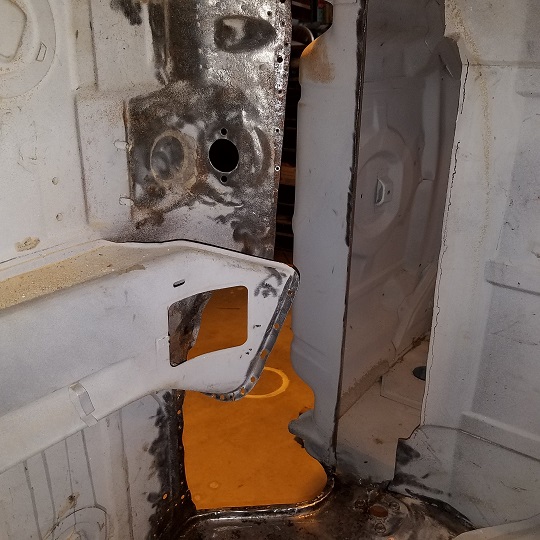

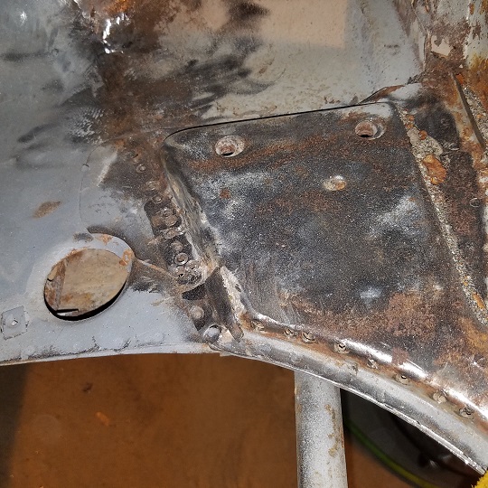

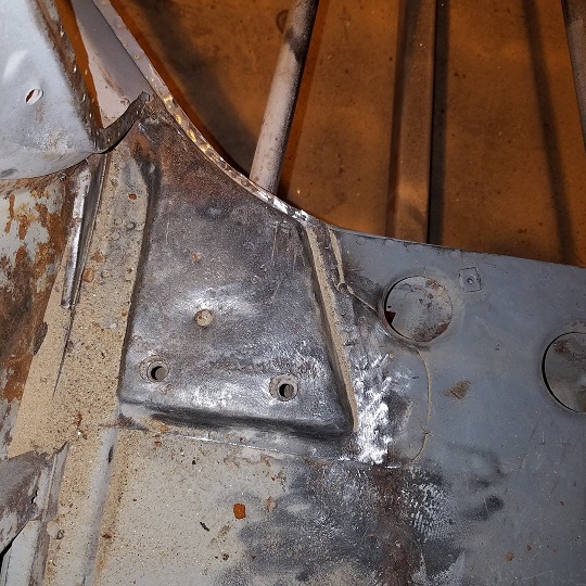

Next was the tune up of the hinge support and dash tie in.
Yes, the blasting glass continues to fall out of the long ...............

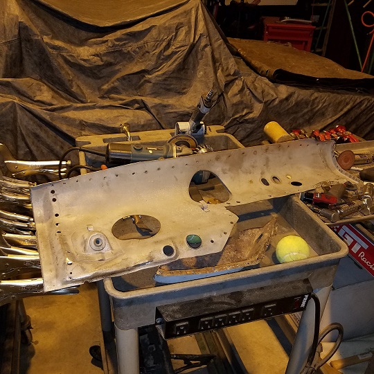

After close inspection I decide the floor/firewall/chassis tie in braces need new flanges rather than trying to fill in the damage done by the spot weld removal.
Went to Rothsport today and stomp sheared some 1/2" 20ga strips.

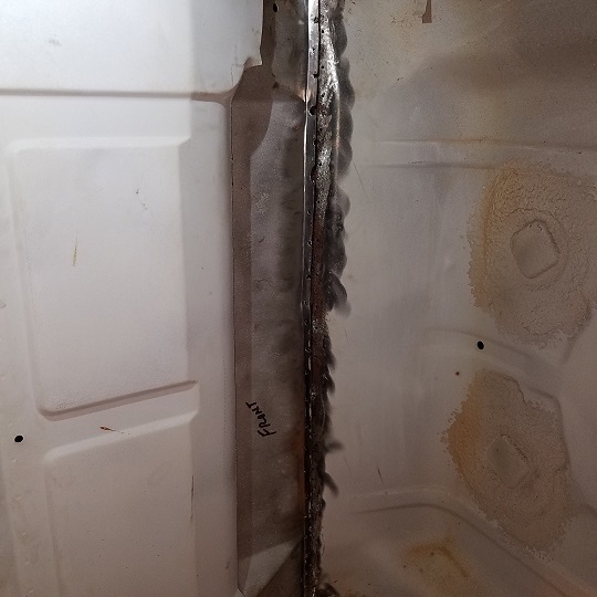

Then it was time to start the fitting of the replacement fuel tank/firewall lower portion.
It's going to take some time determining the cut out. Nothing was left of original section. It came out in pieces.
The lower section of the fender/fuel tank will be installed after the section above.

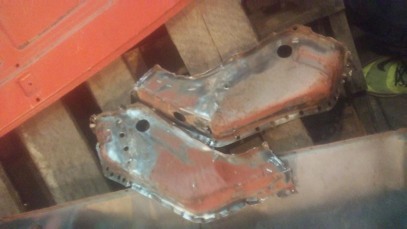

Taylor.914   Prepping the donor.   Aug 6 2018, 09:29 PM
Taylor.914   RE: Taylors new project thanks to Wes   Aug 6 2018, 09:29 PM
