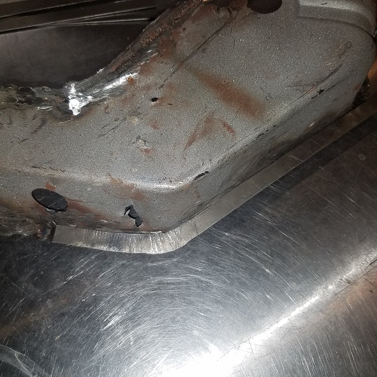

Forgot to post Sunday's work.
Started the day by seeing if I could shrink the 1/2" strips I sheared at Rothsport.
We'll come back to those later ................
