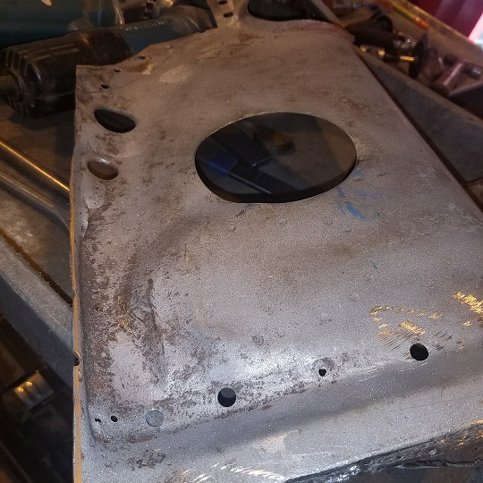

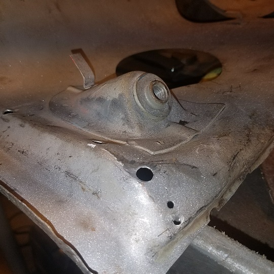

Next onto the seriously dented cross-member mount.
I decided the mount would have to come off first so I can pound out the dent.
That's supposed to be flat .....................
I'm surprised Jack didn't catch it when he dropped the front suspension.
Off she came.
Ended up with an oil can dent inside the orange lines. Tried to move the metal too fast.
Needs to be in the car and solidly attached. Shrinking hammer was enough. I'll fire up the shrinking disk after the patch panel is solidly welded in.
