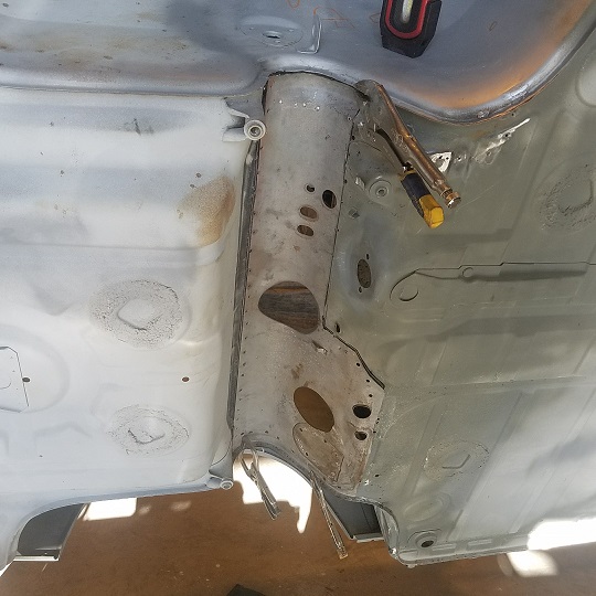

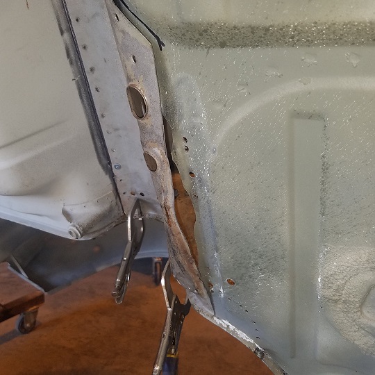

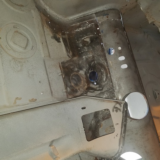

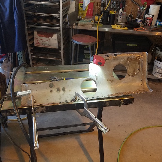

Then it was time to start fitting and trimming .................
Here's the bottom of the cross-member mount dent.
It will take some tuning to get the edge to line up correctly.
Then it was time to fill all the spot weld cutter holes.
