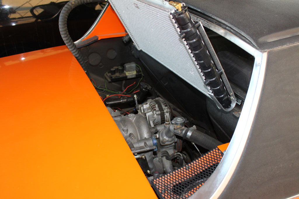

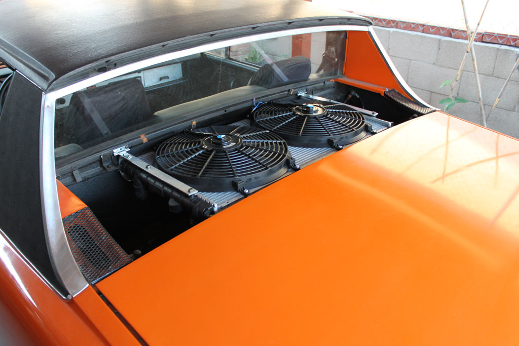

Low speed/low load shouldn't be taxing on just about any cooling system provided it's properly bled. High load is where you get into trouble.
QUOTE(hockeymutt @ Jan 1 2018, 05:27 PM) *
Have any picture?
I'm not sure that this is the Cherokee radiator (I think the cherokee is a bit wider), but you get the idea. Not great for engine access though...
