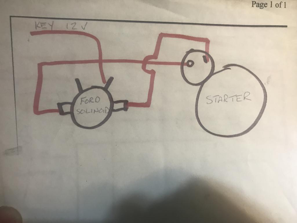

This drawing is mine from back in the early days of the 914world, then part of the club.
(IMG:http://www.914world.com/bbs2/uploads/post-9964-1514863838_thumb.jpg)

Mark Henry   This drawing is mine from back in the early days o...   Jan 3 2018, 10:09 AM
