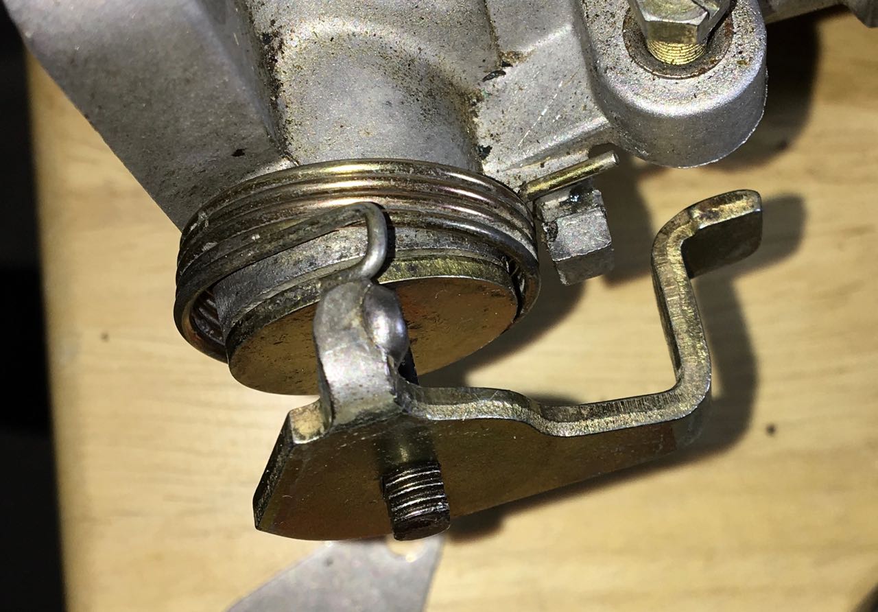

I'm trying to put the CSP Type 4 Porsche kit onto my DRLA 45s. The instructions at https://www.csp-shop.com/technik/pdf/deeng/18236.pdf are for IDFs and I made the mistake of following the step about removing the throttle return spring. This seems to have been unnecessary given the way the previous hex bar was installed.
Anyway, I'm a klutz and the spring has more tension than I expected and I'm wondering if anyone has any special trick for getting it wound up again.

98101   I'm trying to put the CSP Type 4 Porsche kit o...   Jan 4 2018, 07:33 PM
Perry Kiehl   There's usually only about a half turn on that...   Jan 4 2018, 08:06 PM
MarkV   Needle nose pliers or small set of vice-grips. Put...   Jan 4 2018, 08:21 PM
98101   Needle nose pliers or small set of vice-grips. Pu...   Jan 5 2018, 01:10 AM
98101   I had to use more like 8 ft/lbs of torque (twice t...   Jan 5 2018, 02:18 AM
98101   I unscrewed the pushrod (why is it called that whe...   Jan 5 2018, 05:47 AM
