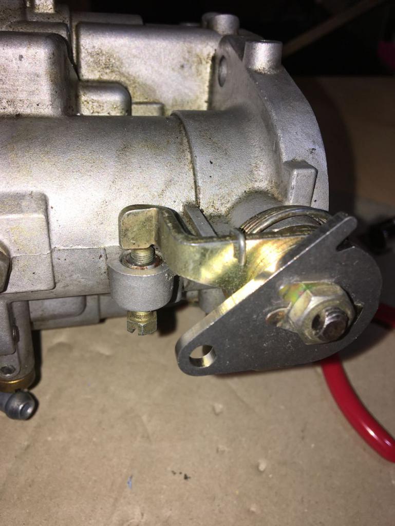

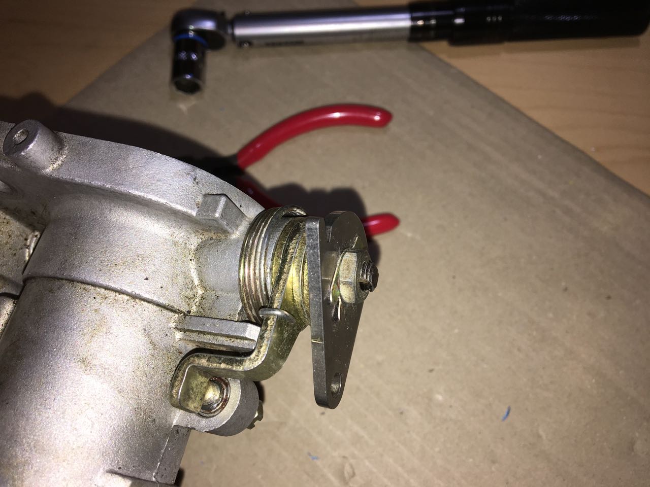

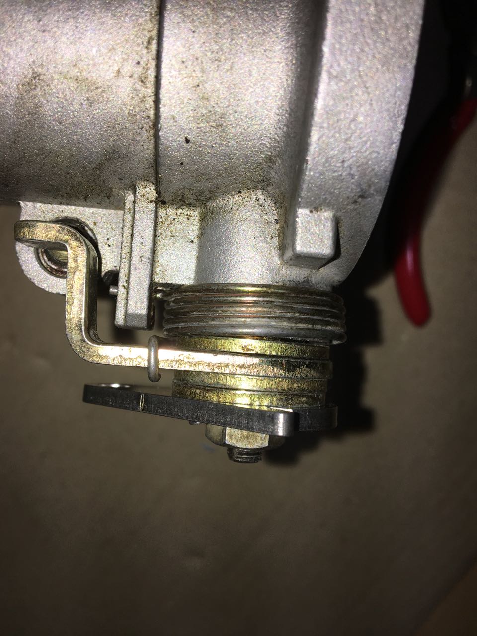

98101   I'm trying to put the CSP Type 4 Porsche kit o...   Jan 4 2018, 07:33 PM
Perry Kiehl   There's usually only about a half turn on that...   Jan 4 2018, 08:06 PM
MarkV   Needle nose pliers or small set of vice-grips. Put...   Jan 4 2018, 08:21 PM
98101   Needle nose pliers or small set of vice-grips. Pu...   Jan 5 2018, 01:10 AM
98101   I had to use more like 8 ft/lbs of torque (twice t...   Jan 5 2018, 02:18 AM
98101   I unscrewed the pushrod (why is it called that whe...   Jan 5 2018, 05:47 AM
