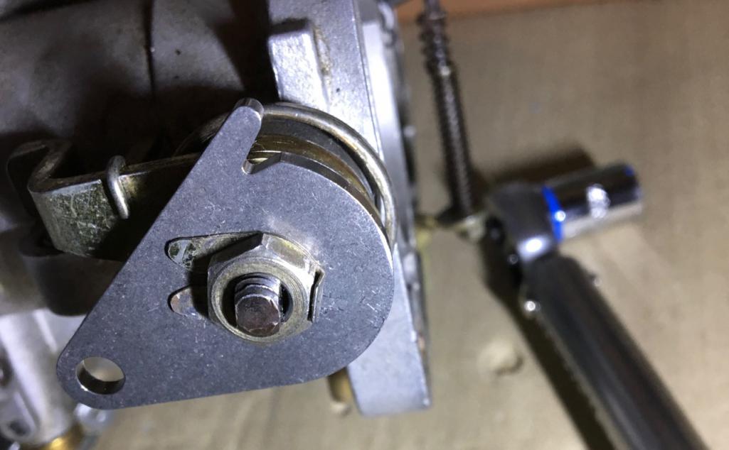

I had to use more like 8 ft/lbs of torque (twice the amount in the instructions) to get the SW11 throttle control shaft nut to align with the lock tab. I hope The Maker will forgive my transgression.

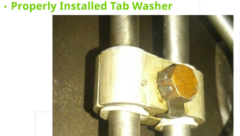

UPDATE: I found this picture of "properly installed tab washer" online. I do not see how my tab washer can perform its function on the CSP throttle lever, and wondering if I should just replace it with a conventional washer.
(Or ignore this as a trivial issue and keep going with the CSP installation since it's taking longer than I expected.)
