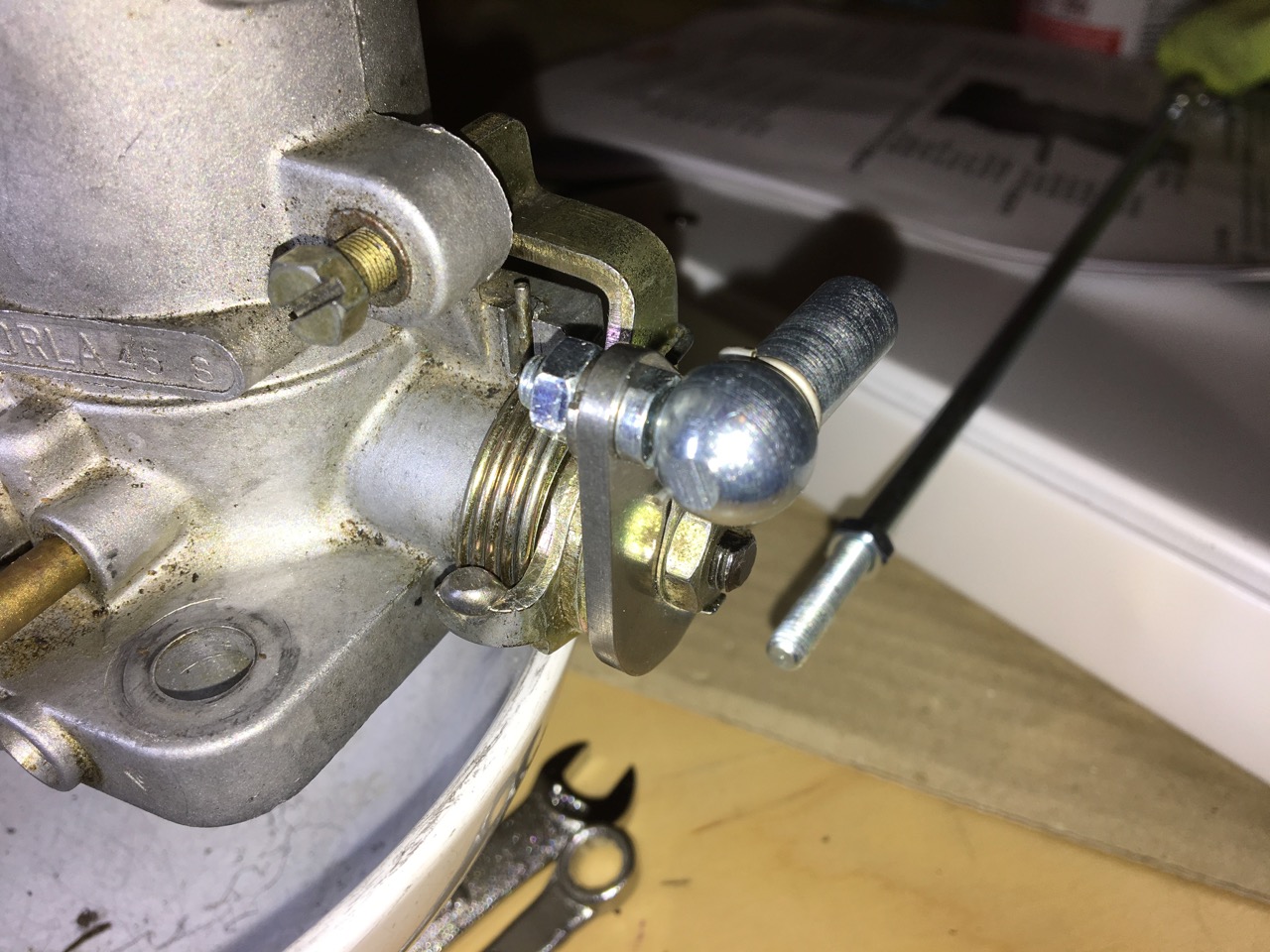

I unscrewed the pushrod (why is it called that when it actually pulls?) and attached the little ball socket to the CSP lever, using 8mm and 7mm spanners. I guess the next step is to put this left carburetor back on the engine and pull the right one.
