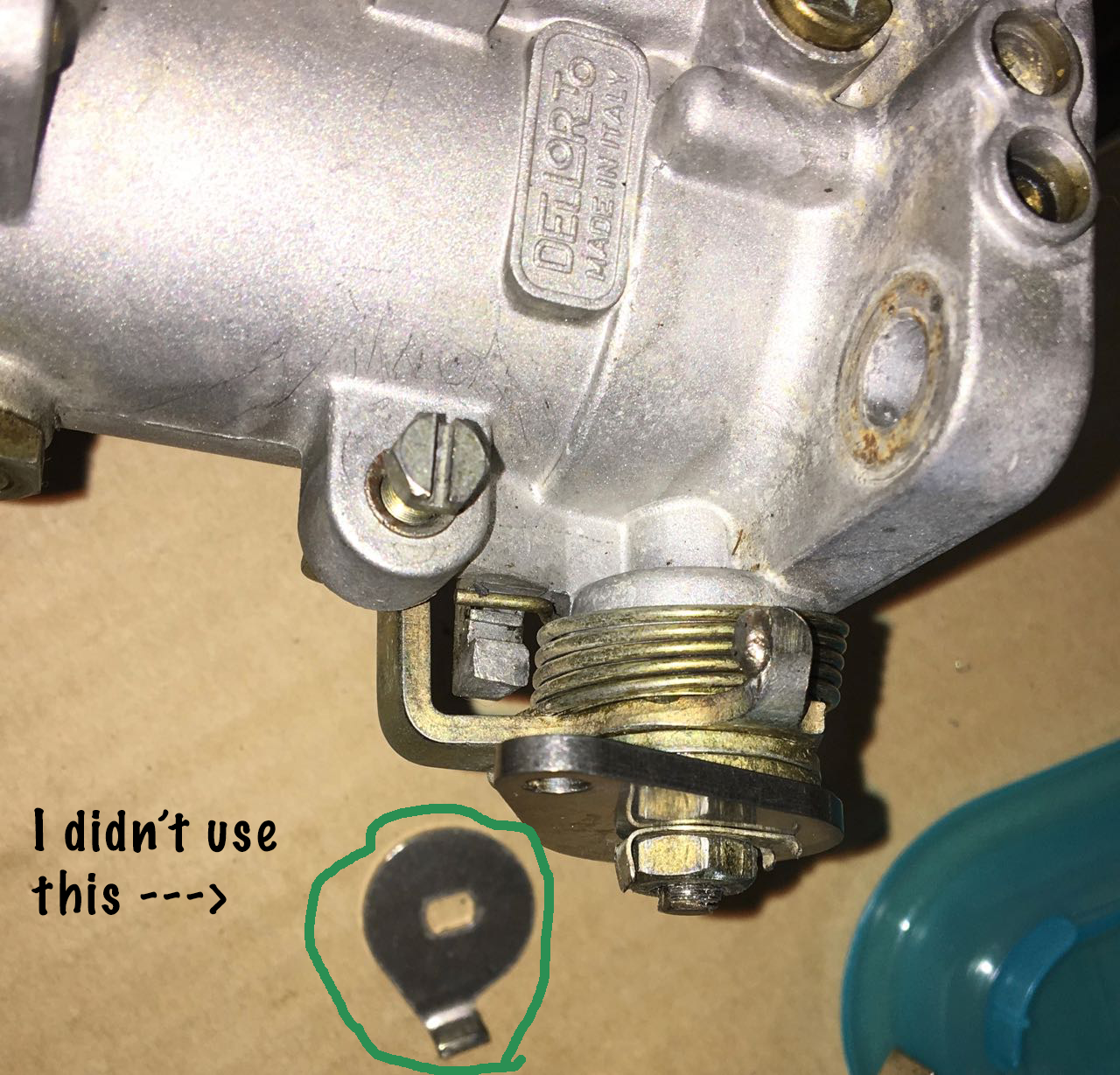

For some reason the right carburetor wasn't as covered with muck like the left one was. I still tried to clean it up a little with carb cleaner, aka wife repellent. Next time I would probably buy brake cleaner instead.
The right side was way easier since I didn't make the mistake of undoing the spring.

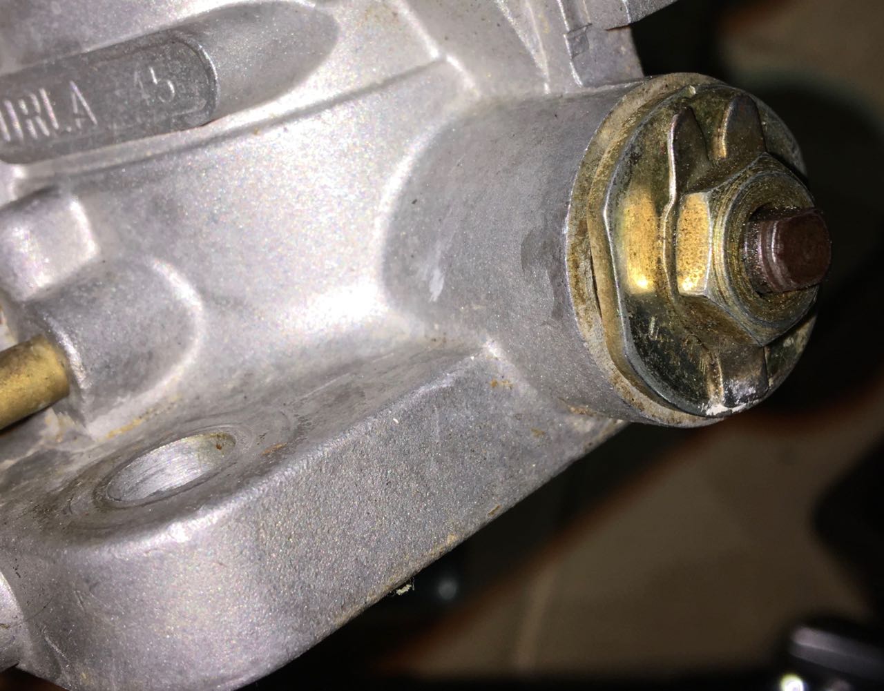

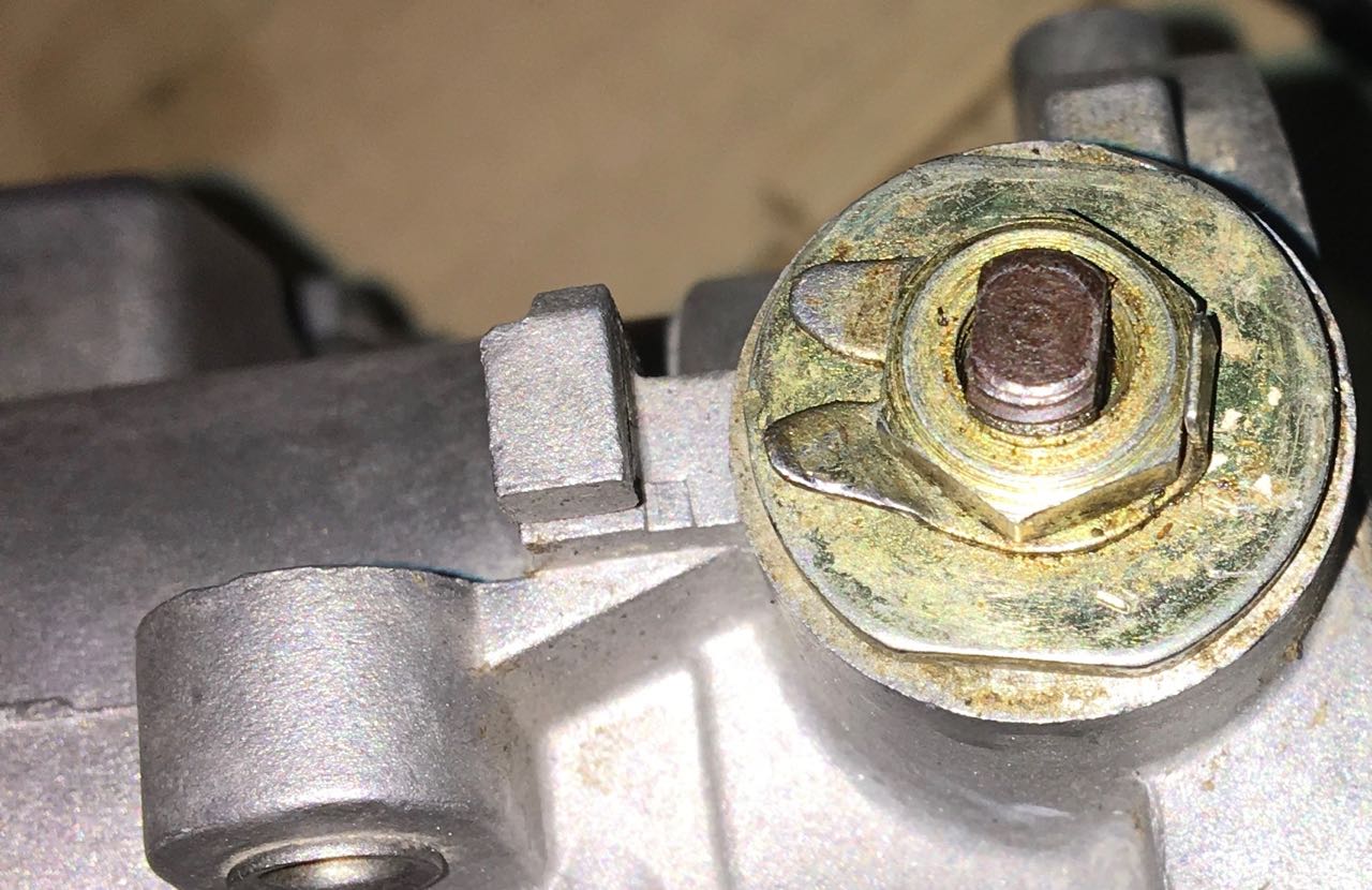

I noticed the other (front) end of the throttle shaft had an unlocked lock tab.
So I locked it. I'm curious how often these have actually fallen off.
The kit for IDF had another feature I didn't seem to need, as far as I can tell.

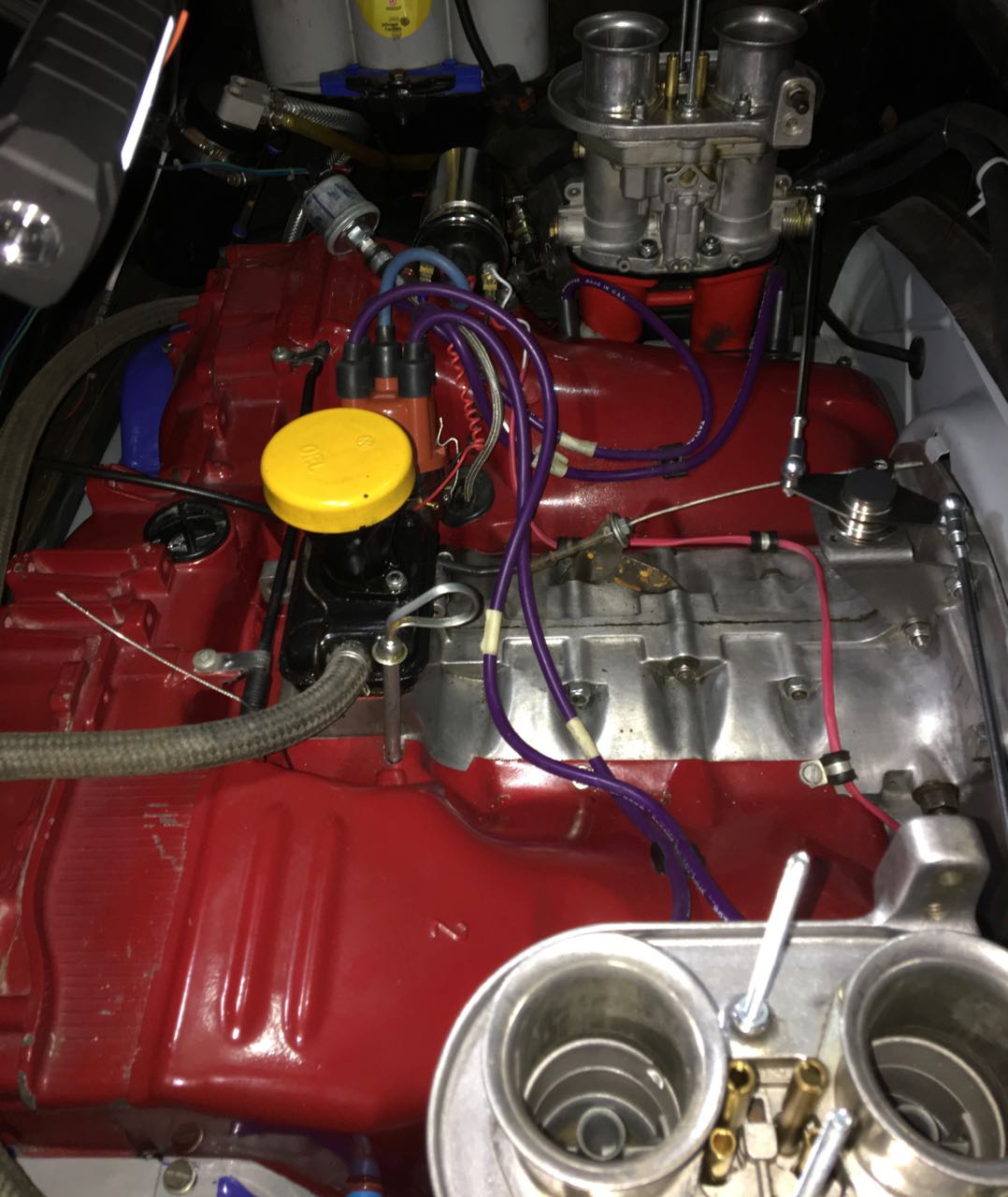

Engine compartment is much tidier without the hex bar. (I'm still wondering why there's oil spewed all around the filler.)
