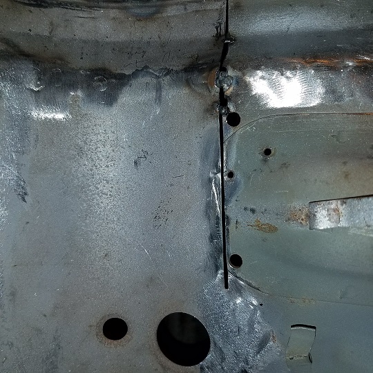

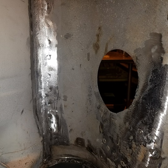

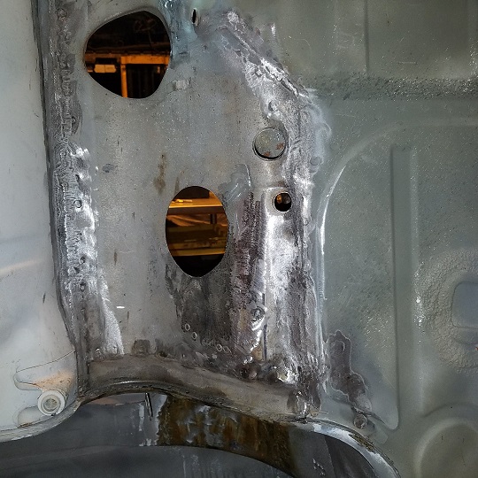

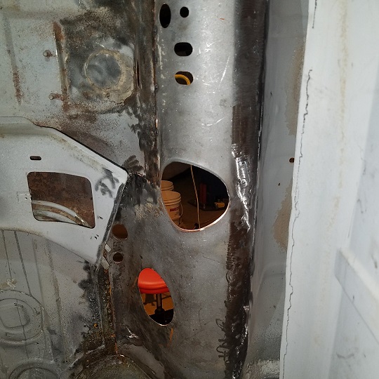

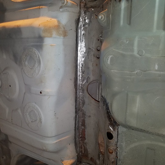

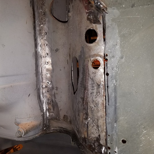

Friday didn't quite go as planned so I went back to work on Taylor's car.
Finished the stitching and got the front seam welded in. Didn't over finish the bottom. It will be under coated. The top side finished up real nice and its ready for the wall section.
Then it was back to the oil canned section next to the fuel tank access hole.

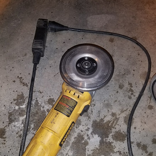

The little shrinking disk takes quite a long time to get the metal heated up. Or maybe its just cold outside. With the front attached I got about 80% of it out.
On to the passenger floor seam .................
With the front tied down it allowed me to pound it down flat. As it flattened out I trimmed a couple more mms out between the 2 pcs as I went along. Saw blade width.
I even retained the drain slot ...............
6 inches to go on the back side. I have a piece to trim down to replace the section that got scalped during cut out.
