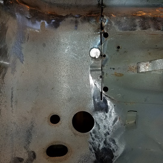

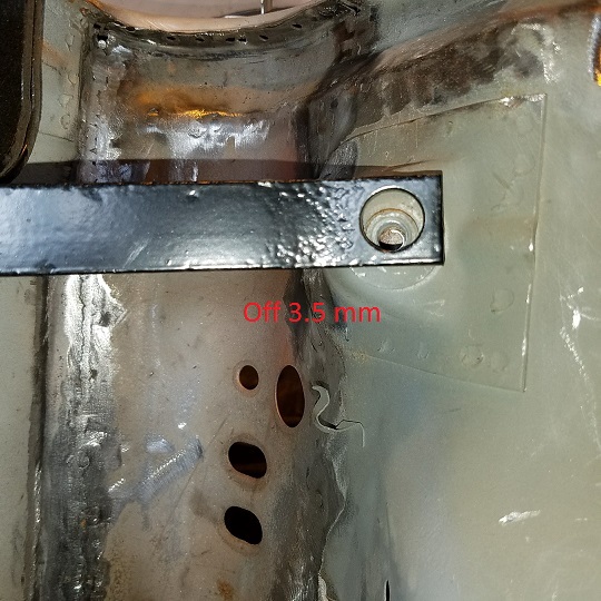

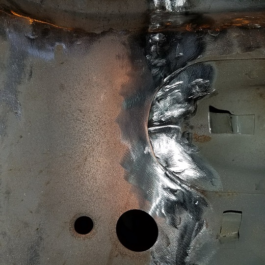

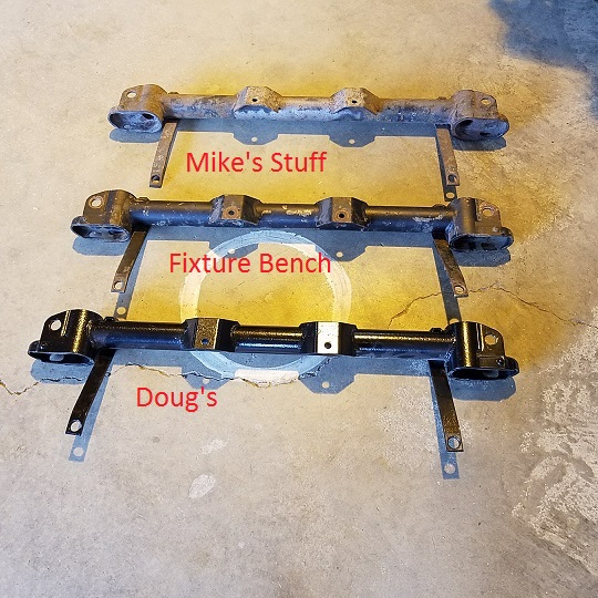

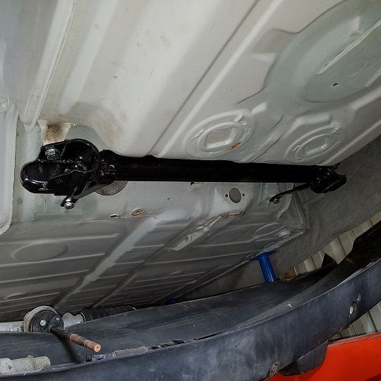

Got the tip welded back on ...........
After test fitting Doug's old cross member it looks like we have a little issue.
I'll do some measurements tonite to see where we're off. I have the car on the frame bench to measure against.
Yes, I could make it fit. Bigger Hammer. But I don't want to use up our given +/- tolerance with a hammer.
Doug's mount fits into my project car, like butter.
Taylor brought out his cross member and it fits like Doug's so we'll go with that.
Odd thing though. The cross member we'd set aside for the frame bench fits into Taylor's car as is. Who knows ......... They should all fit the same ............. Strap(s) tweaked.
