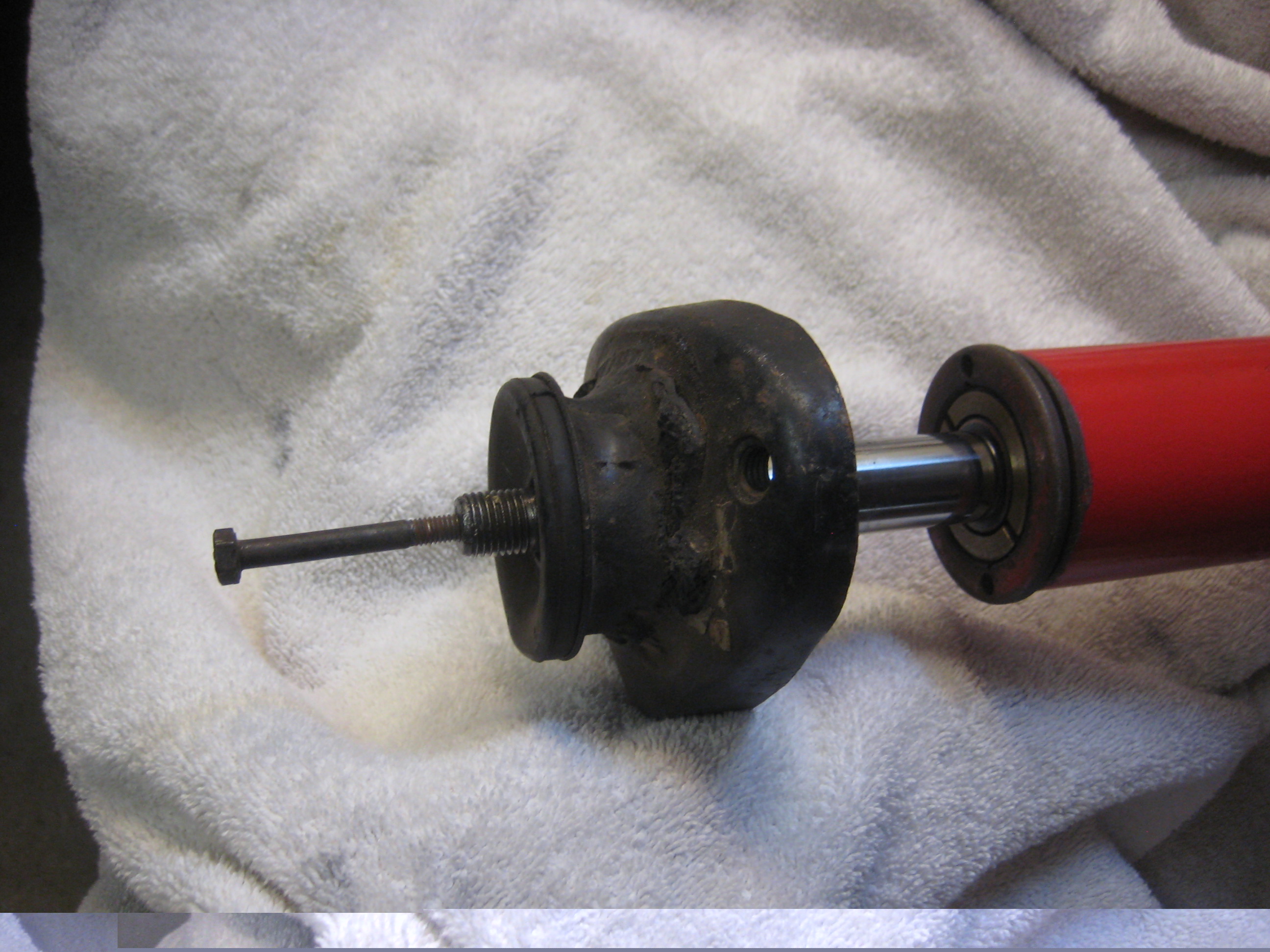

One thing to add.
It is difficult to force the top of the strut up into the mount
on the fender.
Especially because the shaft cannot be grabbed with the dust sleeve in place.
The top of the shaft (Boge,Koni) has threads inside.
Thread a 2" long (m 6 x 1.0 ) bolt into the top of the strut, push the long bolt up through the strut top mount , then use a Vise Grip on the long bolt to pull the shaft up into position.
