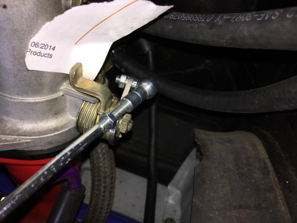

I didn't try adjusting the CSP linkage until the next day. I used both the fingertip technique I learned from you guys (touching one while looking at the other), and also tried using paper as a feeler gauge, like a zero-lash valve adjustment. From the photo you'll see I used the CSP installation instructions for paper. This was the only use I got from the instructions, as they were written for IDFs not DRLAs.
When I tested with the air-flow meters later, the left and right carb were more in sync than I had ever gotten them before. (But there were other, much worse problems I'll describe next.)

98101   I didn't try adjusting the CSP linkage until t...   Jan 9 2018, 09:13 PM
