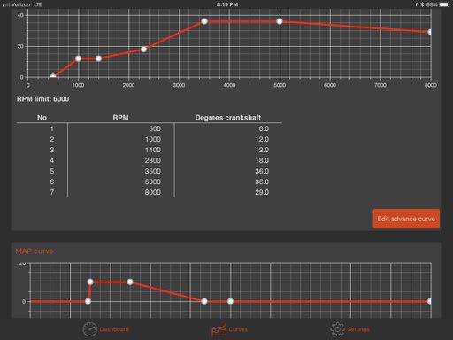

Once the linkage was dialed in, I started the car, looking forward to it running better than ever. Instead, it ran worse than ever. It wouldn't idle, and sounded like it was running on two cylinders. I was alone (without a remote starter), so couldn't get up from the driver's seat to view the engine running after starting it. The iPad was within reach from the driver's seat, so out of desperation I tried the "TUNE" button on the 123 Ignition app.
I was surprised to discover it *would* idle (though not very well) when I bumped the advance from 12º (at 1000RPM) to 20º.
BEFORE (wouldn't idle):
AFTER (would idle):
Later I found it idled even faster with the advance at 1000RPM at 40º!
