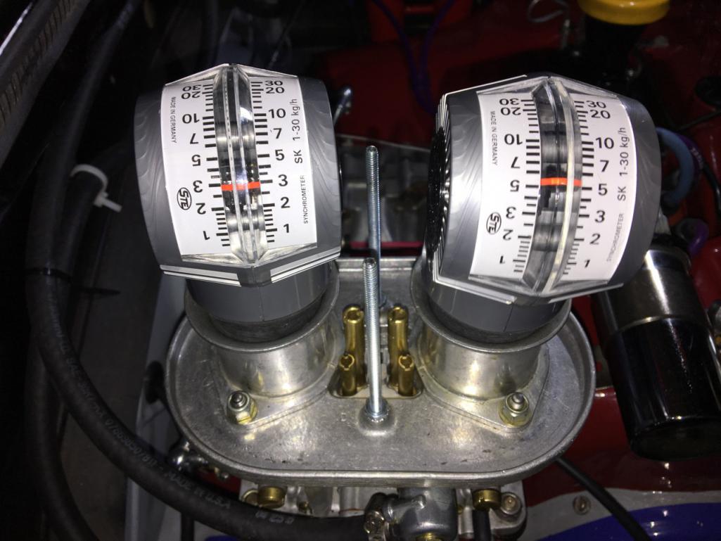

98101   As y'all advised, I bought an air-flow meter. ...   Dec 14 2017, 07:42 PM
MarkV   I always disconnect at least on carb from the link...   Dec 14 2017, 08:19 PM
98101   No reason to by new studs just measure them and t...   Dec 14 2017, 08:36 PM
MarkV   The studs are #10 X 32 thread size.   Dec 14 2017, 08:24 PM
MarkV   I fought with mine when I first set them up. Make ...   Dec 14 2017, 08:54 PM
MarkV   Maybe this will help you: https://www.youtube.com...   Dec 14 2017, 09:23 PM

98101   So the gaskets weren't leaking (at least at id...   Dec 23 2017, 03:54 PM
type2man   Check to make sure the linkage arms both come off ...   Dec 23 2017, 04:48 PM
98101   Check to make sure the linkage arms both come off...   Dec 23 2017, 08:46 PM
MarkV   I does sound like it running on three cylinders. I...   Dec 23 2017, 09:36 PM
98101   If you look at my photo you can see that my actua...   Dec 24 2017, 01:18 AM
type2man   Perhaps the allen screws backed off and the linkag...   Dec 25 2017, 10:23 PM
98101   Perhaps the allen screws backed off and the linka...   Dec 25 2017, 10:54 PM
MarkV   It looks like the hex bar is adjusted all to way t...   Dec 25 2017, 11:44 PM
98101   It looks like the hex bar is adjusted all to way ...   Dec 26 2017, 12:06 AM

98101   For some reason the right carburetor wasn't as...   Jan 6 2018, 01:21 AM
rhodyguy   Cork gasket under the fill Tower assembly? You can...   Jan 6 2018, 07:34 AM
98101   I didn't try adjusting the CSP linkage until t...   Jan 9 2018, 09:13 PM
98101   Once the linkage was dialed in, I started the car,...   Jan 9 2018, 09:27 PM
98101   I couldn't see how changing the linkage and ad...   Jan 9 2018, 09:38 PM
98101   The next morning I limped the car (with frequent b...   Jan 9 2018, 10:19 PM
98101   The Road Test VW shop owner asked me to drive aro...   Jan 9 2018, 11:02 PM
