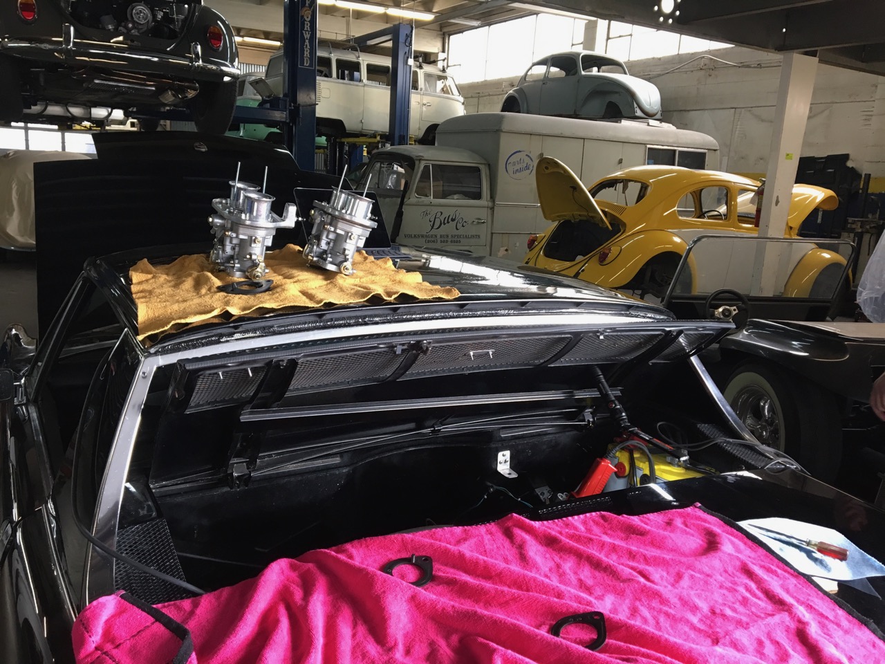

The next morning I limped the car (with frequent bangs from the carbs and sometimes the exhaust) to a VW shop that had been recommended by a 914World member. When I showed the owner the picture of the mismatched throats he expressed his opinion the carburetor was damaged, possibly by a backfire. He also didn't think the mismatch was bad enough to explain how awfully my car was running.
We spent a couple hours fiddling with the tuning. We noticed that all four air bypass screws were open. Closing them had no effect though. Re-open the vacuum ports... no effect. Inspected all the jets. Checked the jet sizes -- they were the original ones that come with the carb. We even tried changing back to the Bosch 009 distributor. No effect. Tamper with the CSP linkage.... no effect. The engine would idle (with soft pops every few seconds), but wouldn't run at 2000RPM. At open throttle it would run faster than 2000RPM though. At higher throttle settings I noticed gasoline splashing and sputtering from the left carburetor -- the leaky one that's generally covered by muck, not the one with the mismatched airflow.
The shop owner admitted that he was stumped. I thought that he would want to open up the carburetors to see what was happening inside, but I guess he sends them to another shop for that.
He did have *another* pair of DRLA 45s, new old stock. We installed those, made a few adjustments, and the engine idled more smoothly than I had ever heard it. At this point we had worked through lunchtime into the afternoon. Once I heard that new-car idle, I had zero desire to put my old scratched, dented, leaky carburetors back on. He called his contact at CB Performance for pricing advice, and suggested he'd sell them for $750. (No, he didn't have any new Webers lying around.) It took me about half a second to decide: YES.
I'm pretty sure y'all will give me some flak for this decision. I'm 80% sure my leaky left carb and my bent right carb could have been fixed, slowly by me, or quickly by a carburetor shop. But I really feel I'm done with those old carbs. The previous owner was using those foam air filters, letting everything in around the edges. He'd left two vacuum ports and four bypass screws open. He had them mounted on deformed gaskets. In one case there was a paper gasket stuck on top of the squishy one. In my care they'd experienced at least a thousand explosions. Who knows what hell these carburetors have been through in their life?
