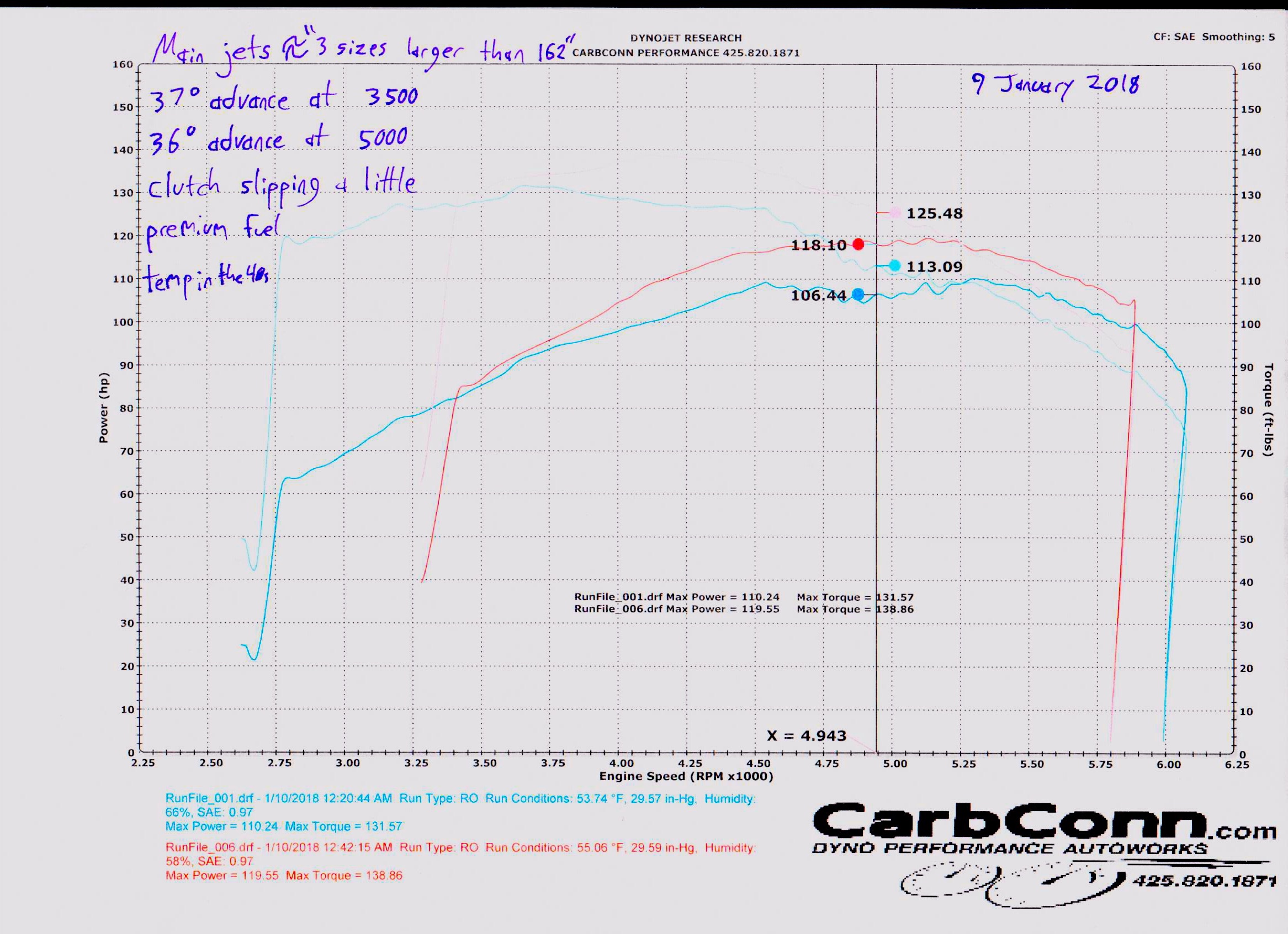

We did some dyno tuning, as you can see here (or in the other thread I started). Air/fuel ratio was lean on the first run and OF COURSE they didn't have Dellorto jets, so I asked him to ream out the existing 165 main jets. (I see that CB Performance sells them.) They had never seen a Bluetooth tunable distributor before. We advanced the overall timing a bit from what I had, which improved the bottom end but detracted from the top end. So we backed down just the top end. I really like the 123 distributor. We didn't explore using vacuum advance to improve drivability... still think there's a lot of potential here since this style of dyno run is only optimizing for wide open throttle.
Car ran fantastically while driving home. Unfortunately it's really raining here so didn't get to play with it.
According to another thread, this dyno result isn't impressive and now it's time to fix the clutch.
