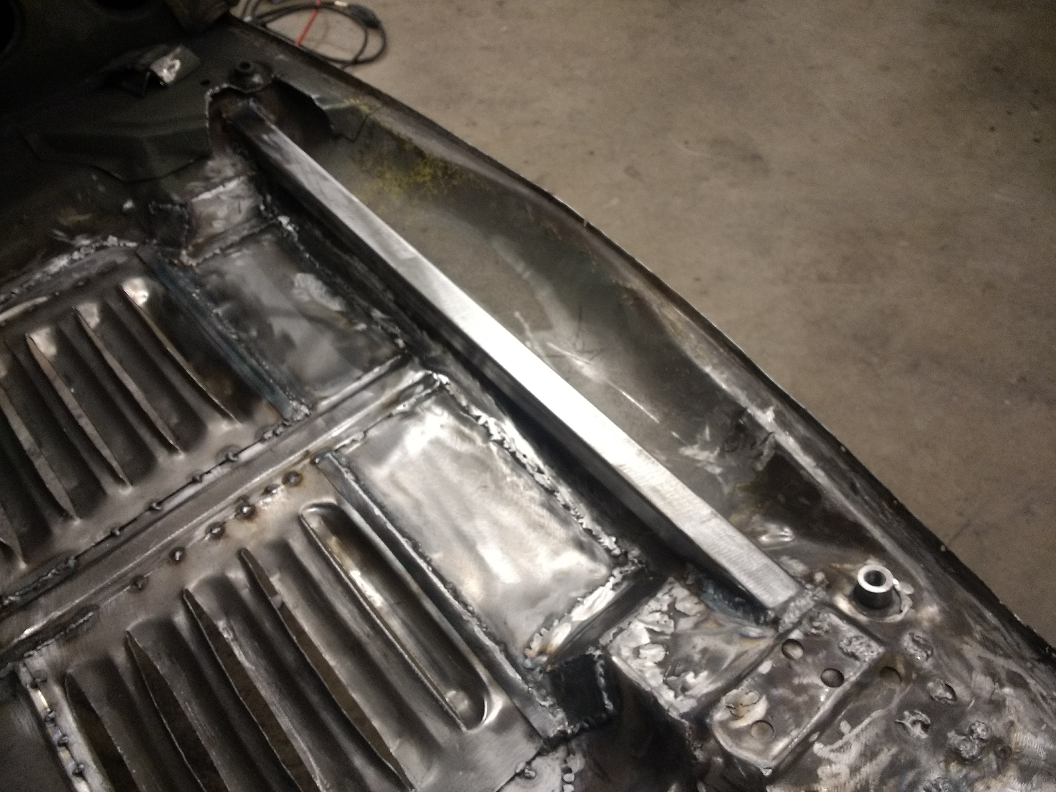

Louvers on the Morgan were harder, the 3003 aluminum is softer, but doesnt hold it shape as easily as steel. Thats why I made the steel stretcher die.
Back on the 914;
Finished floor, with louvers and 1" x 1" bar between front suspension 3 bolt 'pads' for a oil cooler mount and some stiffness for the front end of the car.

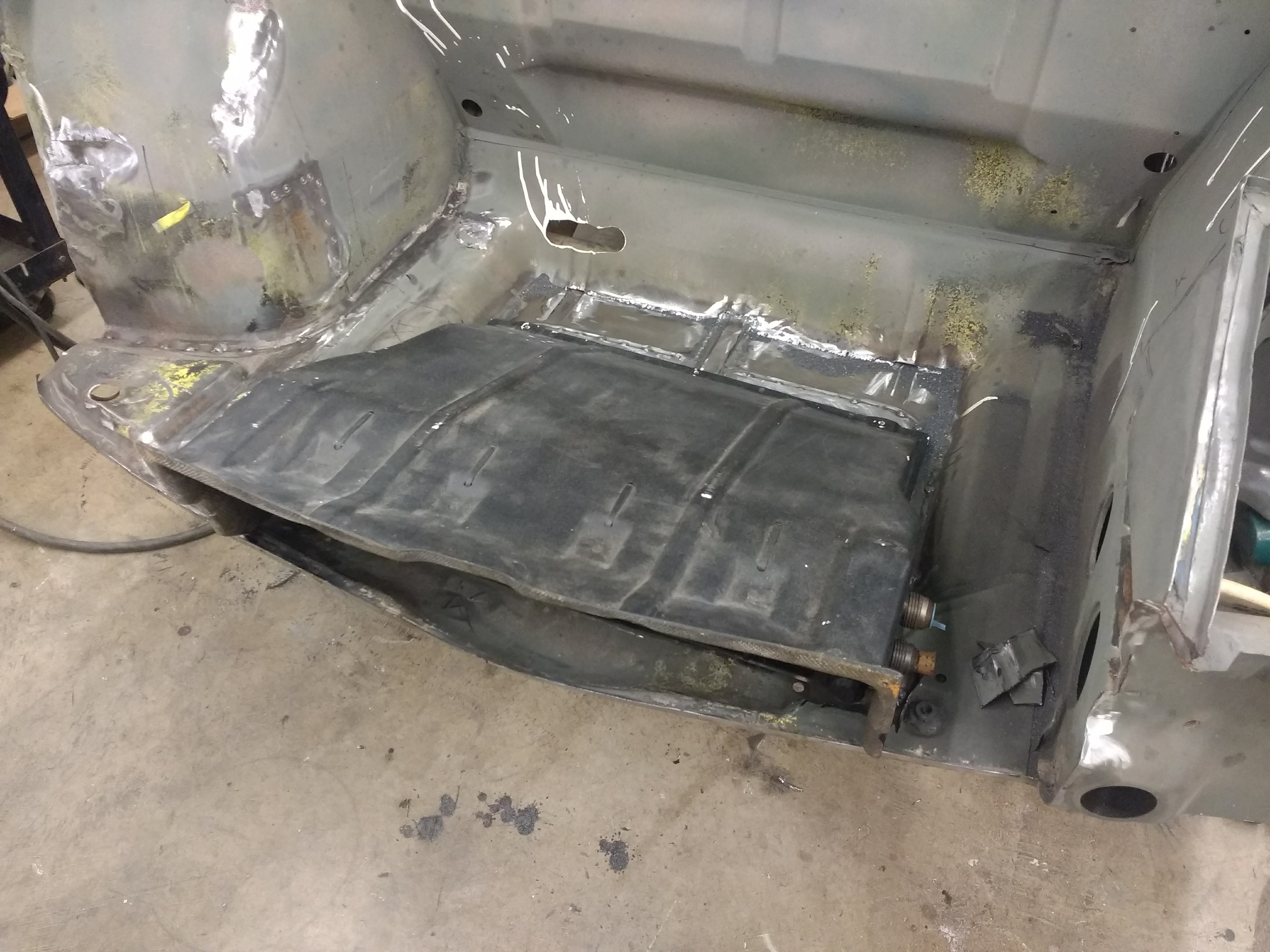

fiberglass oil cooler shroud fits perfectly.
Now, trim and fit the nose panel, then weld it in place, and I'll move to the rear of the car to tidy up (grind off and replace) some old reinforcements and boogered patches on the rear longerons and suspension consoles.
