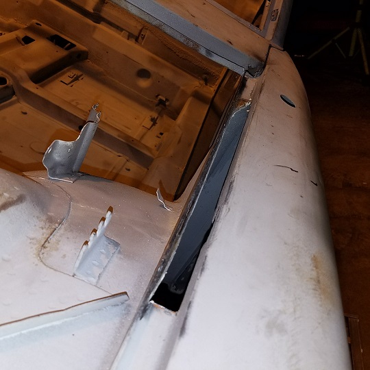

cary   With Super In Law awaiting his release, its time t...   Dec 26 2017, 10:05 AM
cary   Getting off to a chilly start ..................br...   Dec 26 2017, 11:35 PM
cary   After a little more inspecting .................. ...   Dec 26 2017, 11:43 PM
cary   Next it was time to cut out the right fender pee p...   Dec 26 2017, 11:48 PM
Mikey914   Thanks Cary, Looks like it was a little worse ther...   Dec 27 2017, 01:56 AM
cary   Got all bundled up and got back to work. Still 40 ...   Dec 27 2017, 11:26 PM
Mikey914   Good news is it's supposed to be warmer tomorr...   Dec 28 2017, 12:37 AM

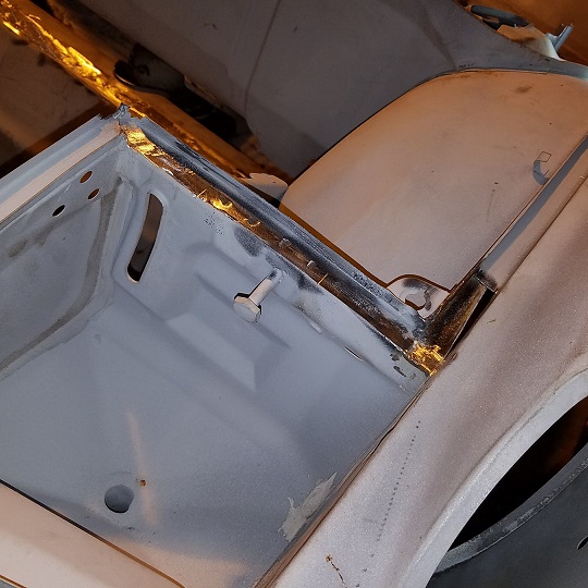

cary   Started with tidying up the thin spots created by ...   Dec 29 2017, 10:55 AM
Mueller   ^wow, great sheet metal work there!   Dec 29 2017, 10:56 AM
jimkelly   man, i love to see a car being blasted right down ...   Dec 29 2017, 12:17 PM
cary   It costs. But it's the only way you find every...   Dec 29 2017, 12:27 PM
Mikey914   This is my gift to my son. He puts in the time, I ...   Dec 29 2017, 02:02 PM
cary   Next was the tune up of the hinge support and dash...   Dec 29 2017, 09:42 PM

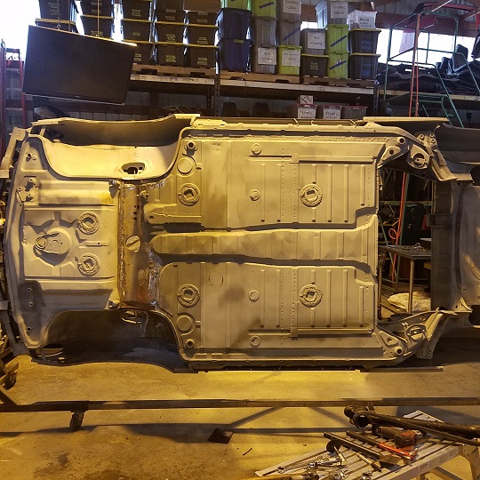

cary   Well I went to the geometry expert for some inp...   Jan 10 2018, 11:10 PM
rick 918-S   Nice work Cary. It's always interesting and ch...   Jan 11 2018, 03:06 AM
tygaboy   Nice work Cary. It's always interesting and c...   Jan 11 2018, 09:03 AM
cary   Well after all the measurements, pictures and emai...   Jan 11 2018, 11:01 PM
rick 918-S   Always enjoy a challenge. :smash: :sawzall: :wel...   Jan 12 2018, 07:06 AM
cary   Here's all the geometry .............. ...   Jan 13 2018, 08:44 AM
