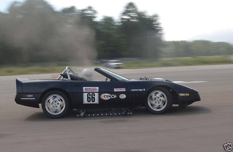

Great local effort to build this car for $2700 bucks, driven by Danny Popp in this picture, set top time of the day several times. But Danny does that with out the sucker car.
