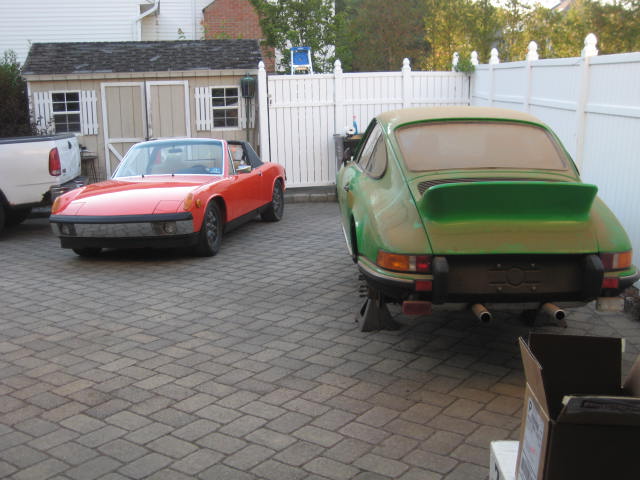

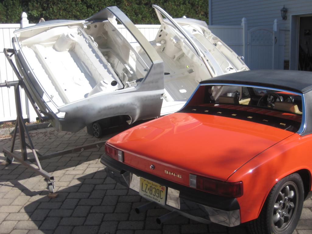

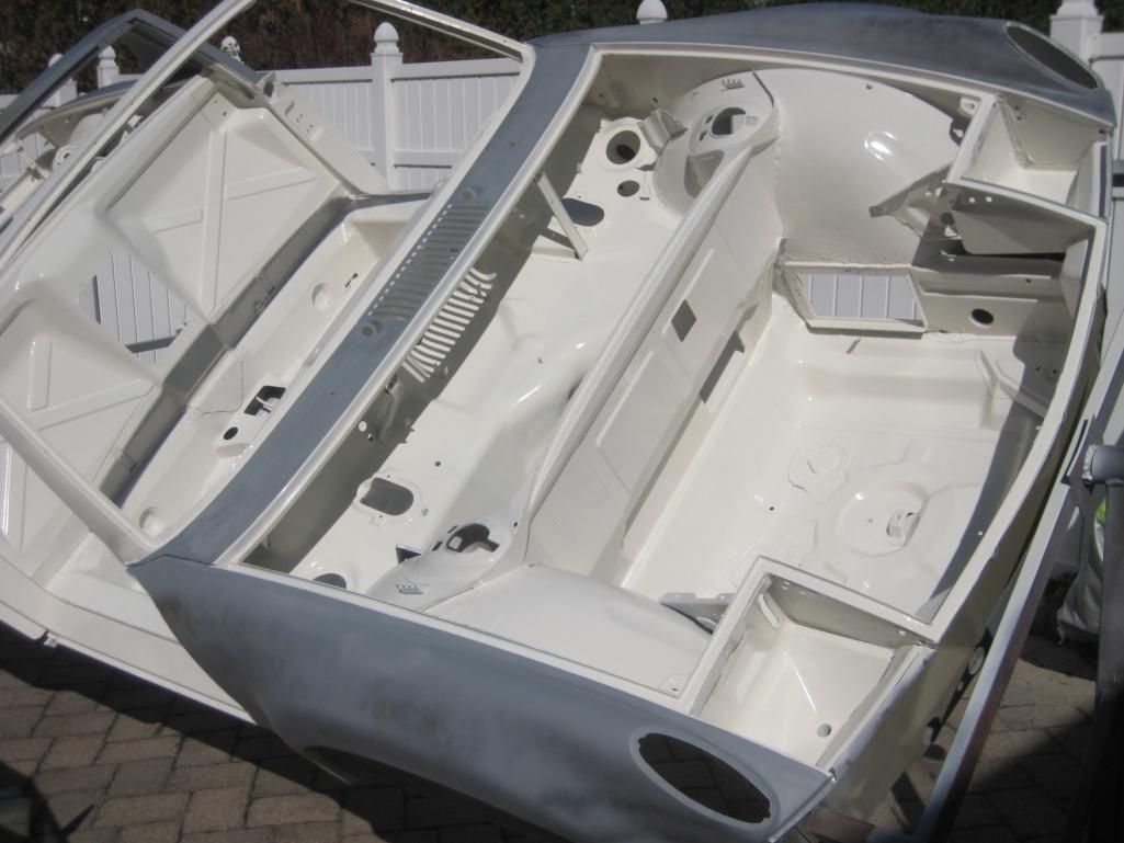

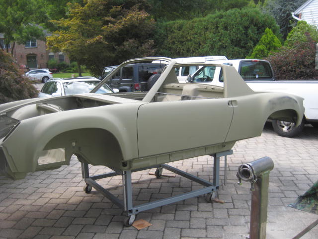

Plenty of progress through the fall months.
Etching primer, metal massage / body work , fitting doors and lids, body schutz, pebble coat, etc.etc. Not my work, I paid an old friend.
By the way two sets of front and rear lids and front and rear bumpers.
Four in fiberglass and four in metal.
In a lull now, doing projects on friends cars. Revived a 73 911 after a 21 year snooze and also revived a '70 914 6 that is 13 VINs from mine. The engines are consecutive numbers ! Fresh engine never started after being rebuilt in 1991 ! by a well known guy I worked for ....way back. Purrs like a kitten.
Attached are some random pics.
