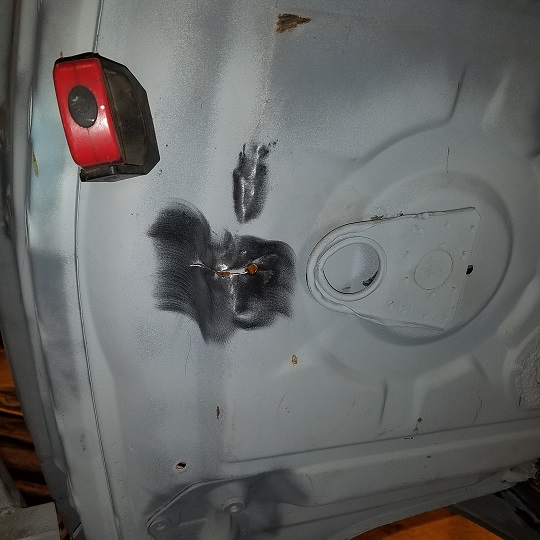

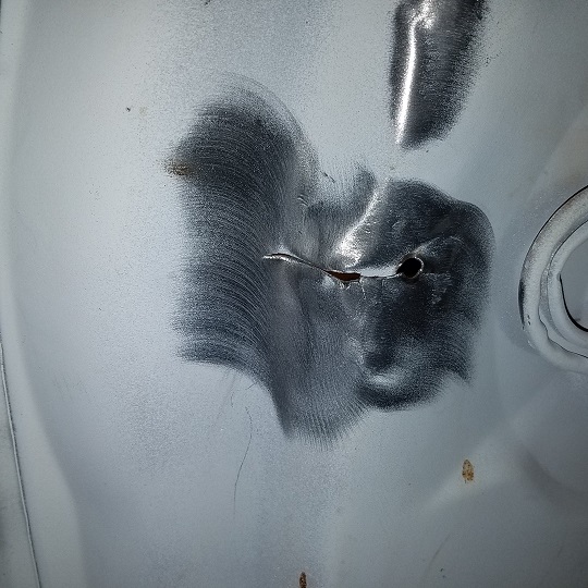

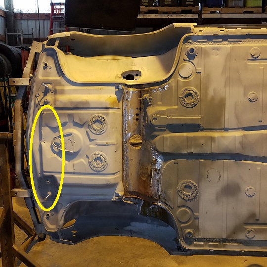

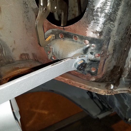

Well after all the measurements, pictures and emails Rick and I came to the consensus that the car took a hit on the right control arm end cap and tire wheel.
pretty significant whack..................
But after all the geometry, it looks to be 2-3 mm both back and to the right. Which is just a smidgen out of tolerance. So back to work ...............

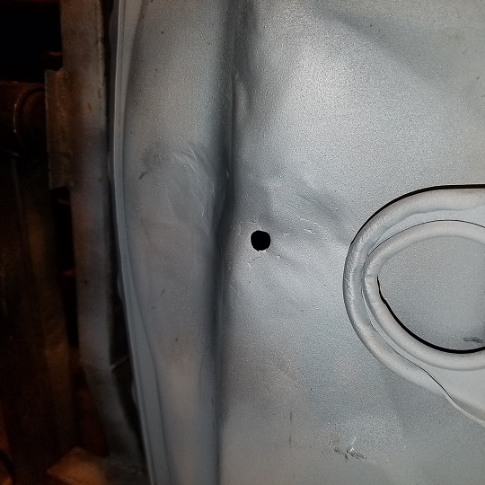

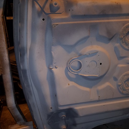

First order of business. I'll fix the split in the tire well.
Needs a little more hammer and dolly work when I have a second set of hands.
Blasted the cross member and gave it a couple coats of cold galvanizing.

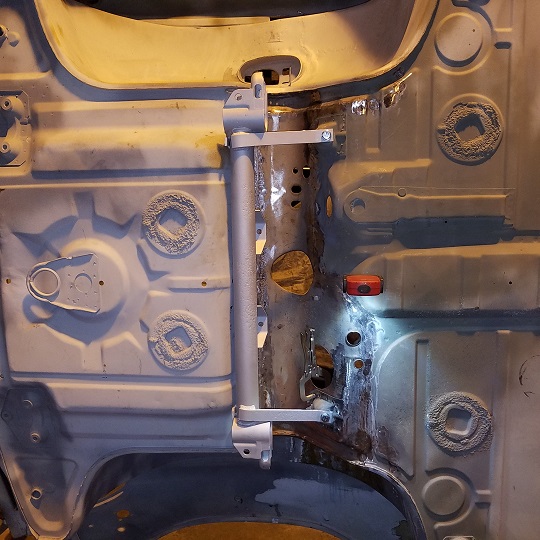

After just a smidgen of tuning and she slipped into place.
Next onto welding in the right rear cross member mount.
