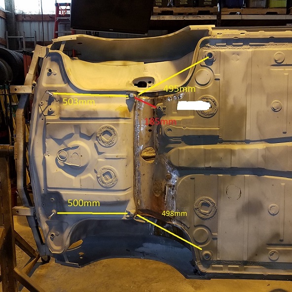

Here's all the geometry ..............
For prosperity's sake, I'll double check my notes on the 498.

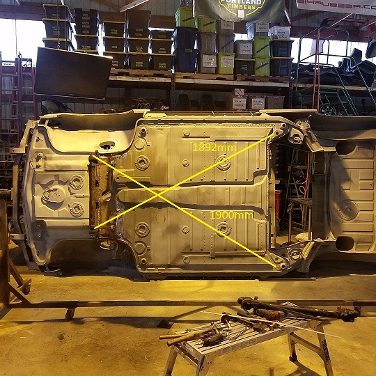

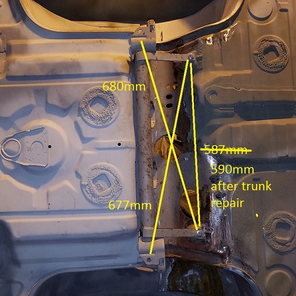

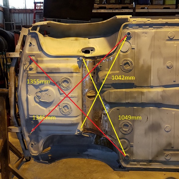

cary   Well I went to the geometry expert for some inp...   Jan 10 2018, 11:10 PM
rick 918-S   Nice work Cary. It's always interesting and ch...   Jan 11 2018, 03:06 AM
tygaboy   Nice work Cary. It's always interesting and c...   Jan 11 2018, 09:03 AM
cary   Well after all the measurements, pictures and emai...   Jan 11 2018, 11:01 PM
rick 918-S   Always enjoy a challenge. :smash: :sawzall: :wel...   Jan 12 2018, 07:06 AM
cary   Here's all the geometry .............. ...   Jan 13 2018, 08:44 AM
