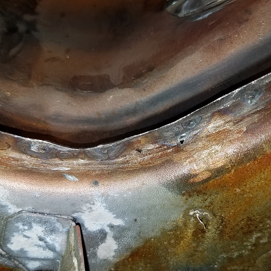

Spent the morning weldng on the right rear cross member mount and re welding the arch. A little dicey ........... The flange took quite a beating coming out. But it came together nicely.
Checking the backside ............. a couple pin holes to fill
Gooder as new .......

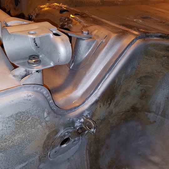

Left last night with the bottom side of the cowl getting an Ospho treatment.
Best guess is the rust freckles are from the Dustless Blaster media left hanging.
Prior to the treatment, Taylor spent about 3 hours removing blasting media from the tub.
Round and round on the rotisserie. Plus some tapping with rubber mallets.
