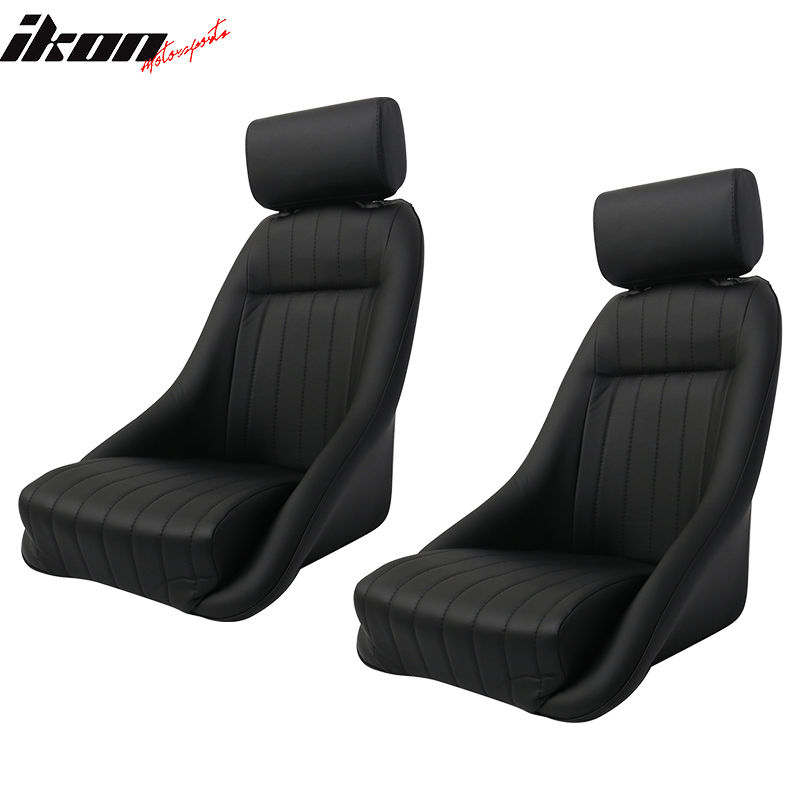

(IMG:http://www.914world.com/bbs2/uploads_offsite/images2post.com-9388-1515886615.1.jpg)
anyone have any experience with these classic bucket replicas?
