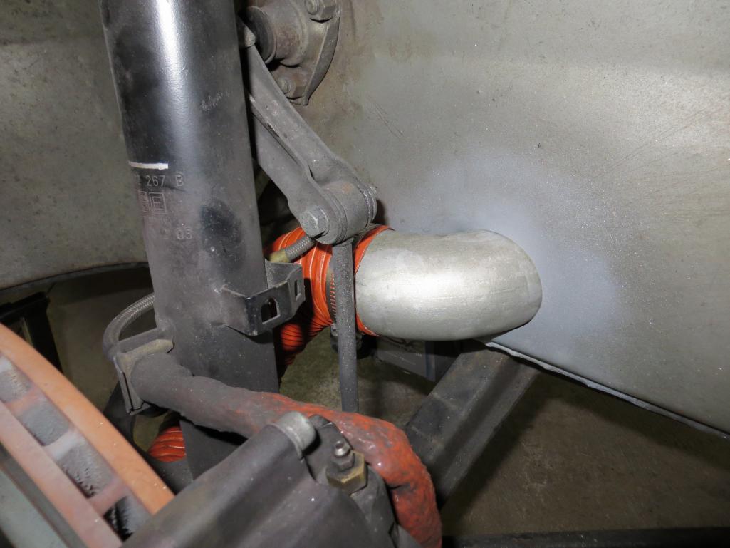

With the Christmas break, I finally took the time to relocate my brake ducts from the A-arm scoops underneath to an integrated location within the oil cooler housing. The trick was finding a location where they did not interfere with the suspension or steering.
I found a couple of 2.5" aluminum elbows off eBay and fit them just above the A-arm behind the sway bar links.

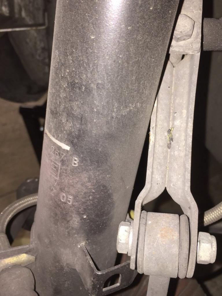

I also discovered that my sway bar had shifted itself to the right and was in contact with the strut housing. Weird that it hadn't happened in the past 10 years.

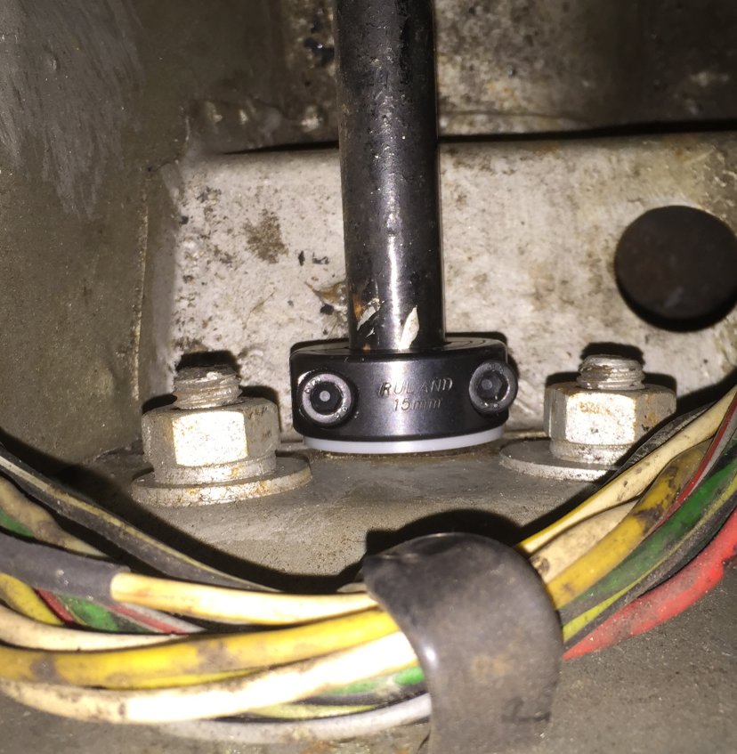

This is the stock 15mm sway bar so I picked up a couple of split clamps from McMaster along with a couple of nylon washers to prevent future squeaking.
First, I re-centered the sway bar. I drilled the 1/2" washers to 5/8", since the local hardware store only had 1/2", and then slit the washers so that they could be installed without removing the bar. They cannot be slipped over the ends of a stock bar because the bar is tapered to a square which engages the sway bar arms. Then, I installed the split collars next to the washers on each side.
