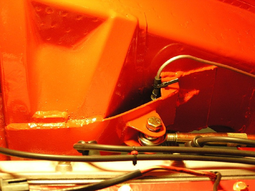

now is the time to add reinforcements. the ova ling happens... but with big tires they also rip out when not reinforced. Attached image(s)
