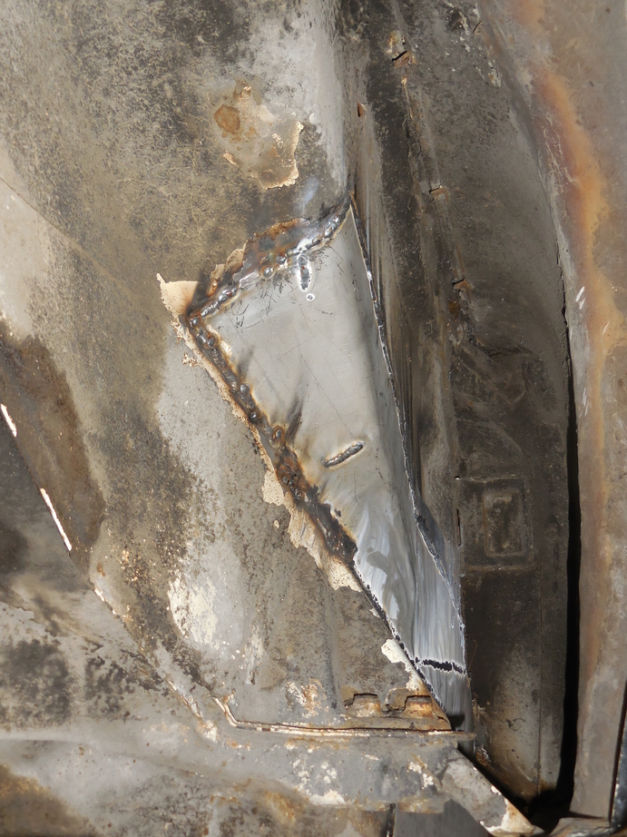

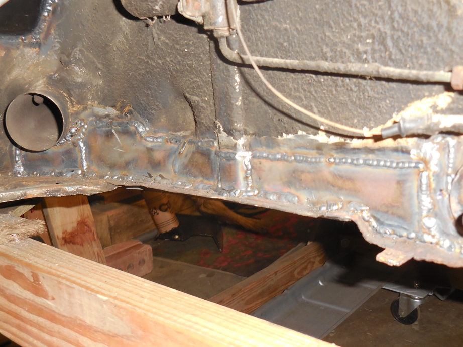

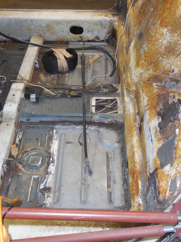

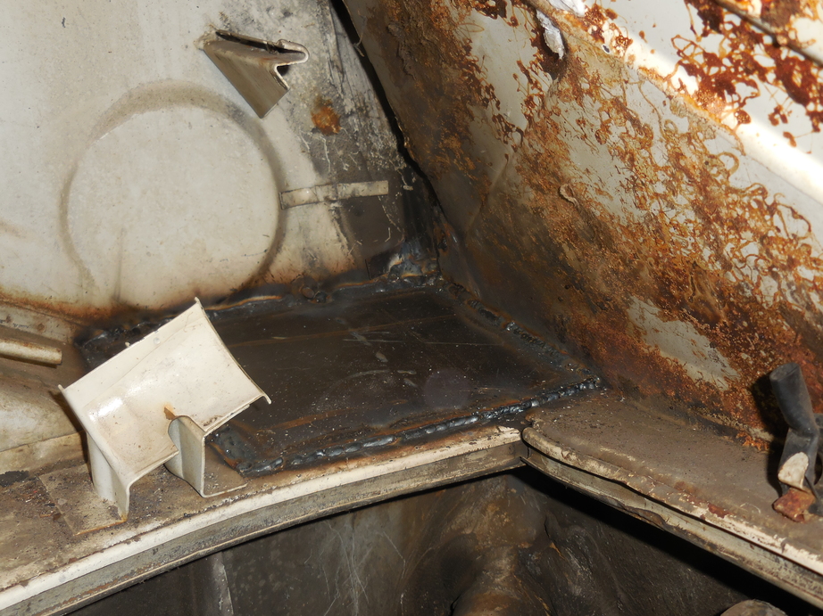

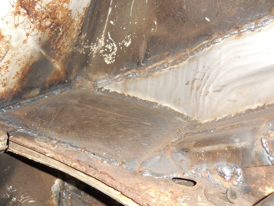

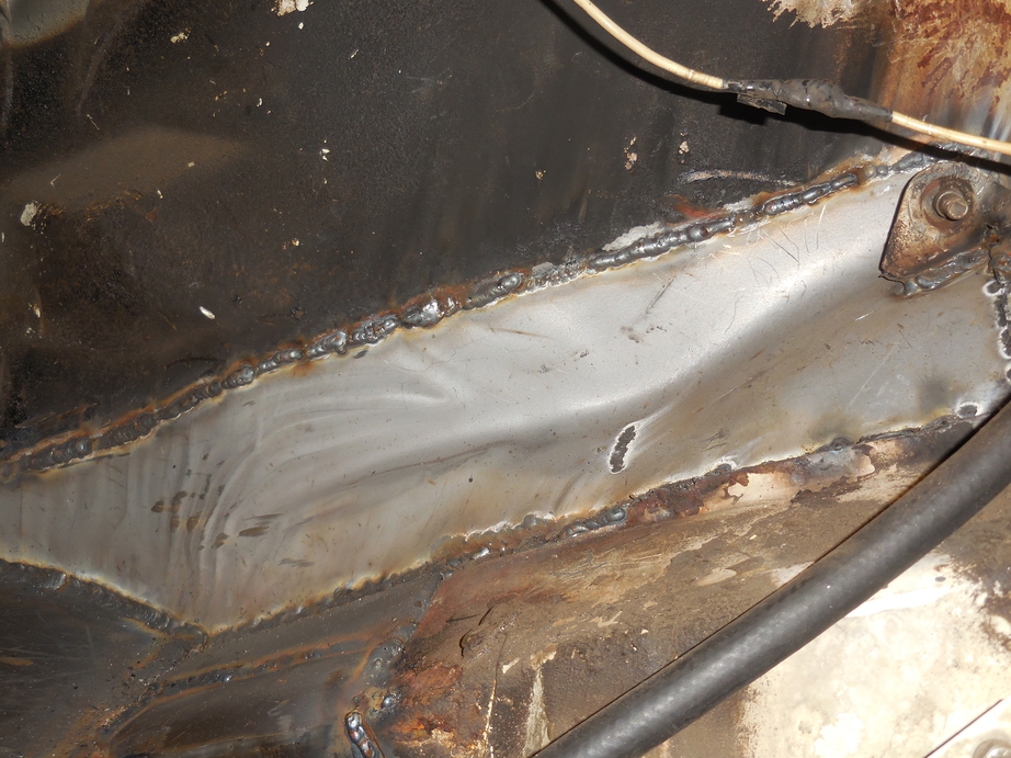

Welding is Completed!!!! (IMG:style_emoticons/default/piratenanner.gif)
Rear Left sideAttached Image
Right side battery trayAttached Image
Right rearAttached Image
right rear fenderAttached Image
Bottom rear panAttached ImageR
