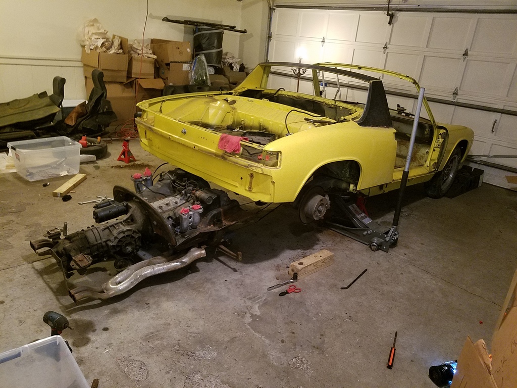

Here is the engine and trans on a furniture dolly.
(IMG:http://www.914world.com/bbs2/uploads_offsite/i1227.photobucket.com-16328-1516466645.1.jpg)

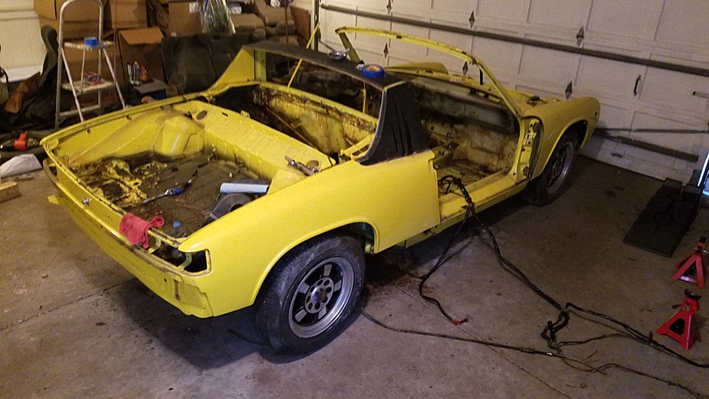

The car mostly stripped.
(IMG:http://www.914world.com/bbs2/uploads_offsite/i1227.photobucket.com-16328-1516466645.2.jpg)

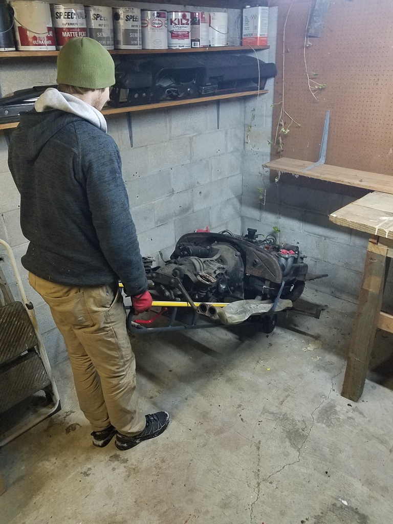

Here is the birthing of the engine from the donor.
(IMG:http://www.914world.com/bbs2/uploads_offsite/i1227.photobucket.com-16328-1516466645.3.jpg)
