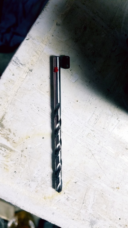

Not sure if this qualifies for being cheap or resourceful. Lost a dowel pin and had a perfect sized HSS drill that I figured could be used. Drill still usable so no big deal.
