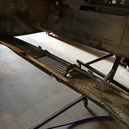

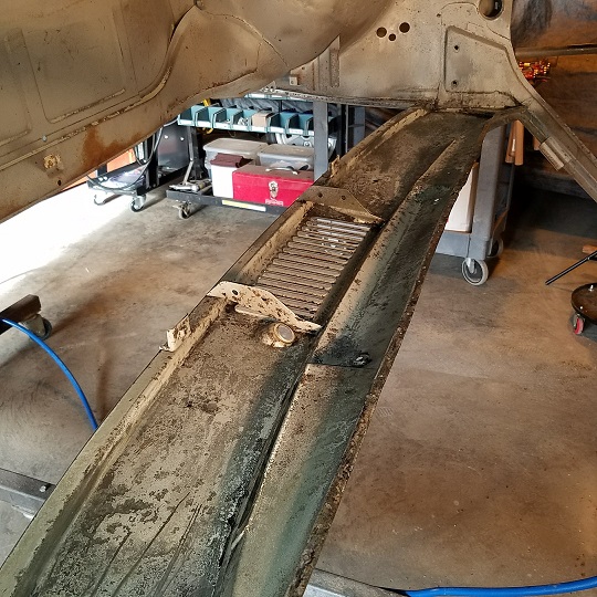

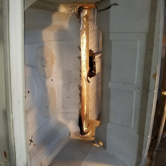

Catch up on Taylor's car.
1st. Treated the bottom side of the cowl with OSPHO. It had quite a bit of over spray or condensation from the paint stripping. After the OSPHO dried Taylor scrubbed it down with a red pad.
Then I gave it two coats of cold galvanizing in case it gets missing during paint.
Forgot to shoot a photo. I'll be back.
2nd. Onto the patch at the base of the cross panel.
