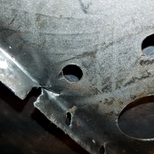

cary   Got all bundled up and got back to work. Still 40 ...   Dec 27 2017, 11:26 PM
Mikey914   Good news is it's supposed to be warmer tomorr...   Dec 28 2017, 12:37 AM
cary   Started with tidying up the thin spots created by ...   Dec 29 2017, 10:55 AM

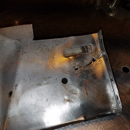

cary   Next was the tune up of the hinge support and dash...   Dec 29 2017, 09:42 PM
cary   Forgot to post Sunday's work. Started the day...   Jan 1 2018, 10:42 PM
cary   Next onto the seriously dented cross-member mount....   Jan 1 2018, 10:55 PM
cary   Then it was time to start fitting and trimming ......   Jan 1 2018, 11:02 PM

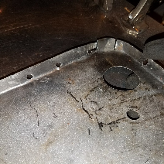

cary   Friday didn't quite go as planned so I went ba...   Jan 6 2018, 09:15 AM
cary   Got the tip welded back on ........... After t...   Jan 7 2018, 11:34 AM

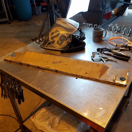

cary   Spent the morning weldng on the right rear cross m...   Jan 13 2018, 09:11 AM
cary   Finished up the left side arch yesterday. Next...   Jan 19 2018, 09:36 AM

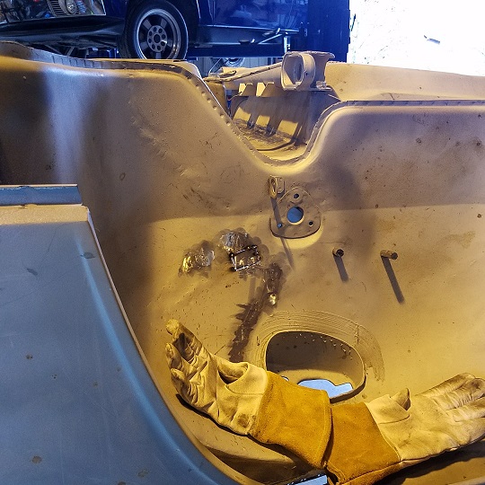

cary   Catch up on Taylor's car. 1st. Treated the bot...   Jan 21 2018, 08:48 PM
cary   Took a little tuning to get it ready to weld in. I...   Jan 21 2018, 08:55 PM
