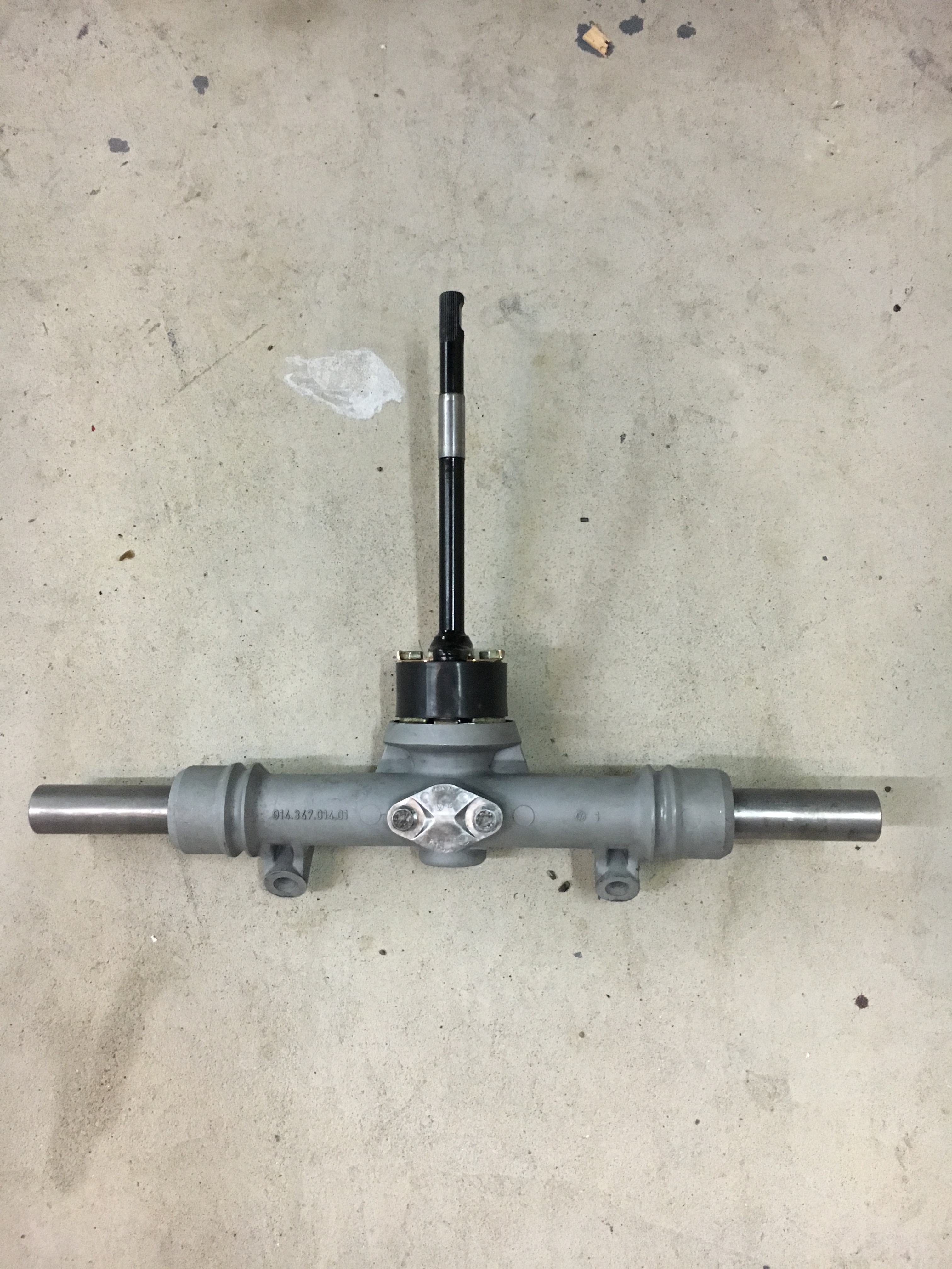

Front - stock torsion bars, stock sway bar, stock A arms, new Elephant Racing rubber bushings, new ball joints, 19mm raised spindle 911T strut bodies with new Bilstein inserts; polyurethane upper strut mounts, 914 Rubber rebuilt steering rack, Rebel Racing spherical tie rod ends with adjustable bump steer and double sheer mounts

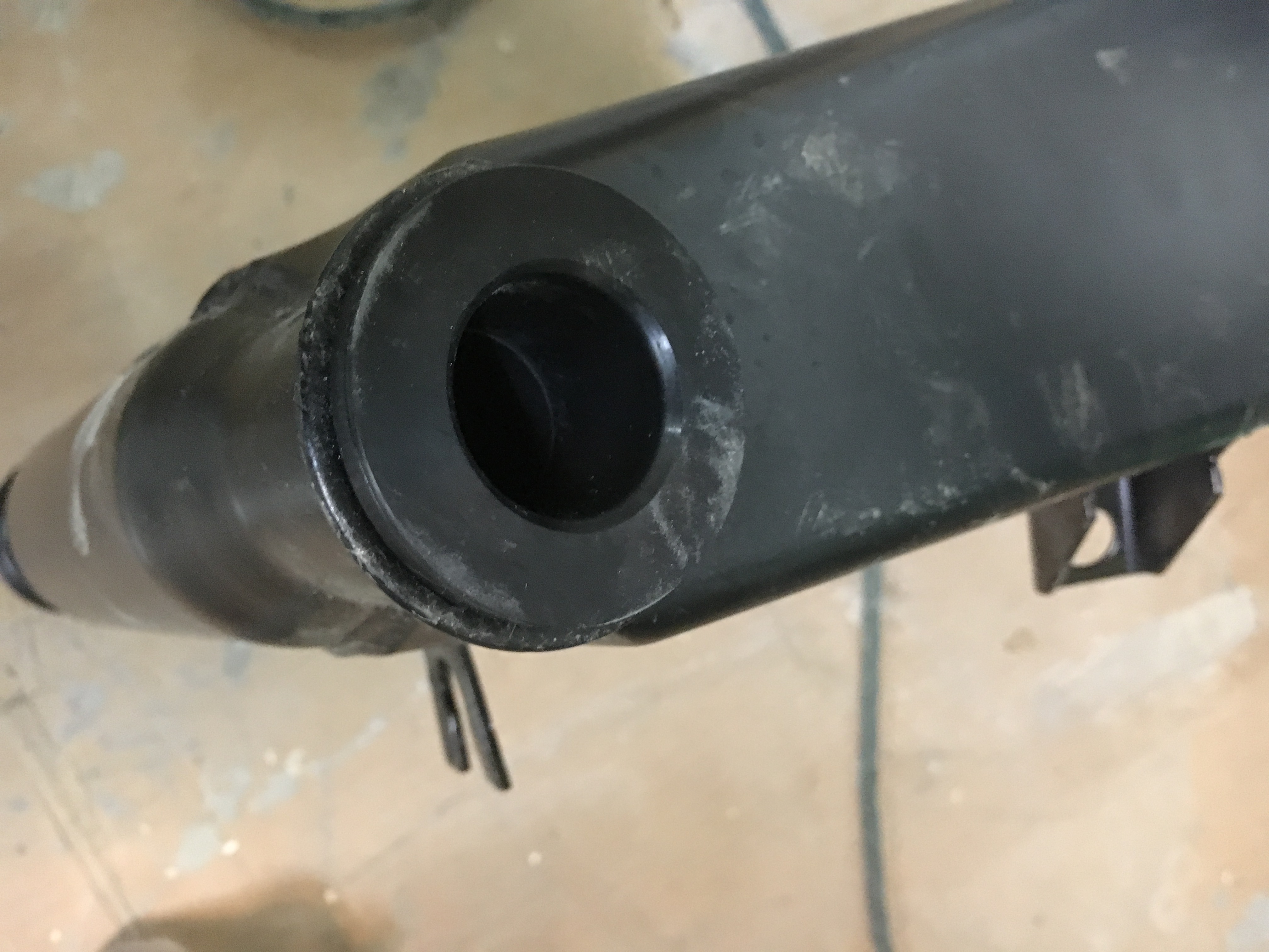

Rear - Bilstein yellow shocks, 140 Weltmeister springs, stock rear sway bar, Elephant Racing rubber rear bushings and upper mounts
