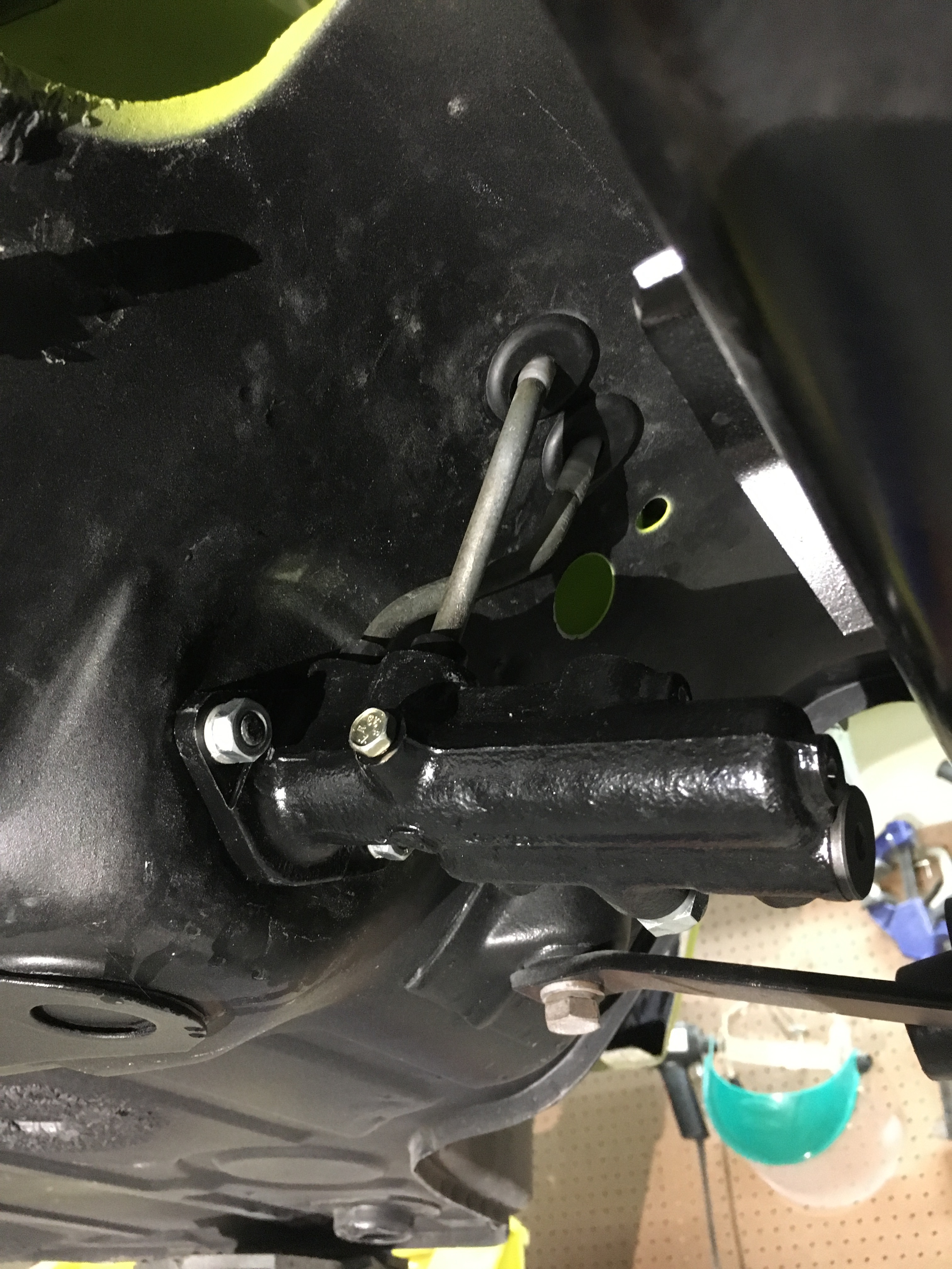

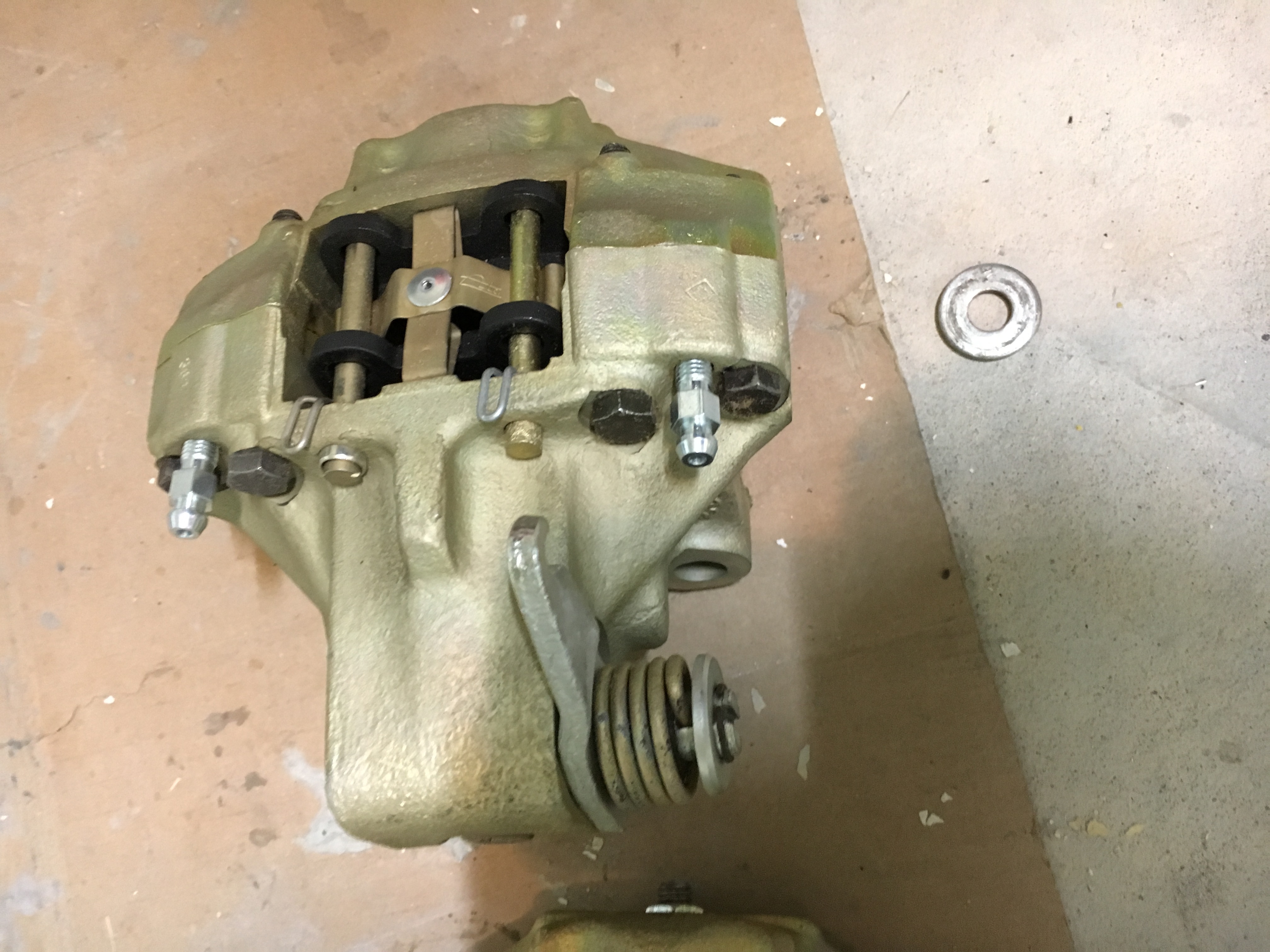

19mm MC with grommets and rebuilt 914 rear caliper

jmitro   19mm MC with grommets and rebuilt 914 rear caliper   Jan 22 2018, 11:35 PM
