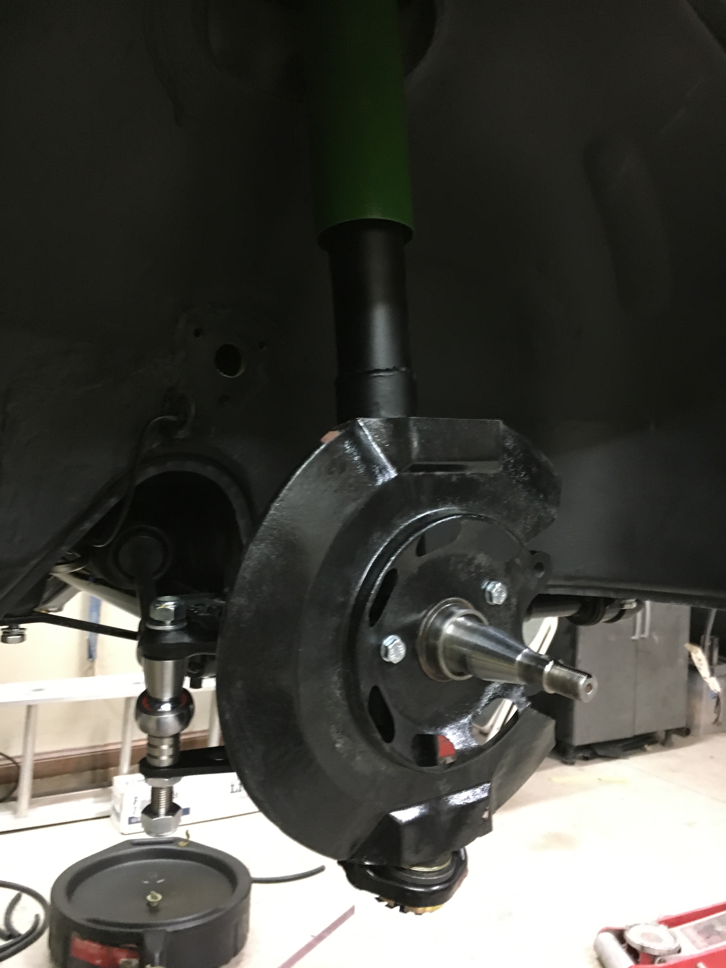

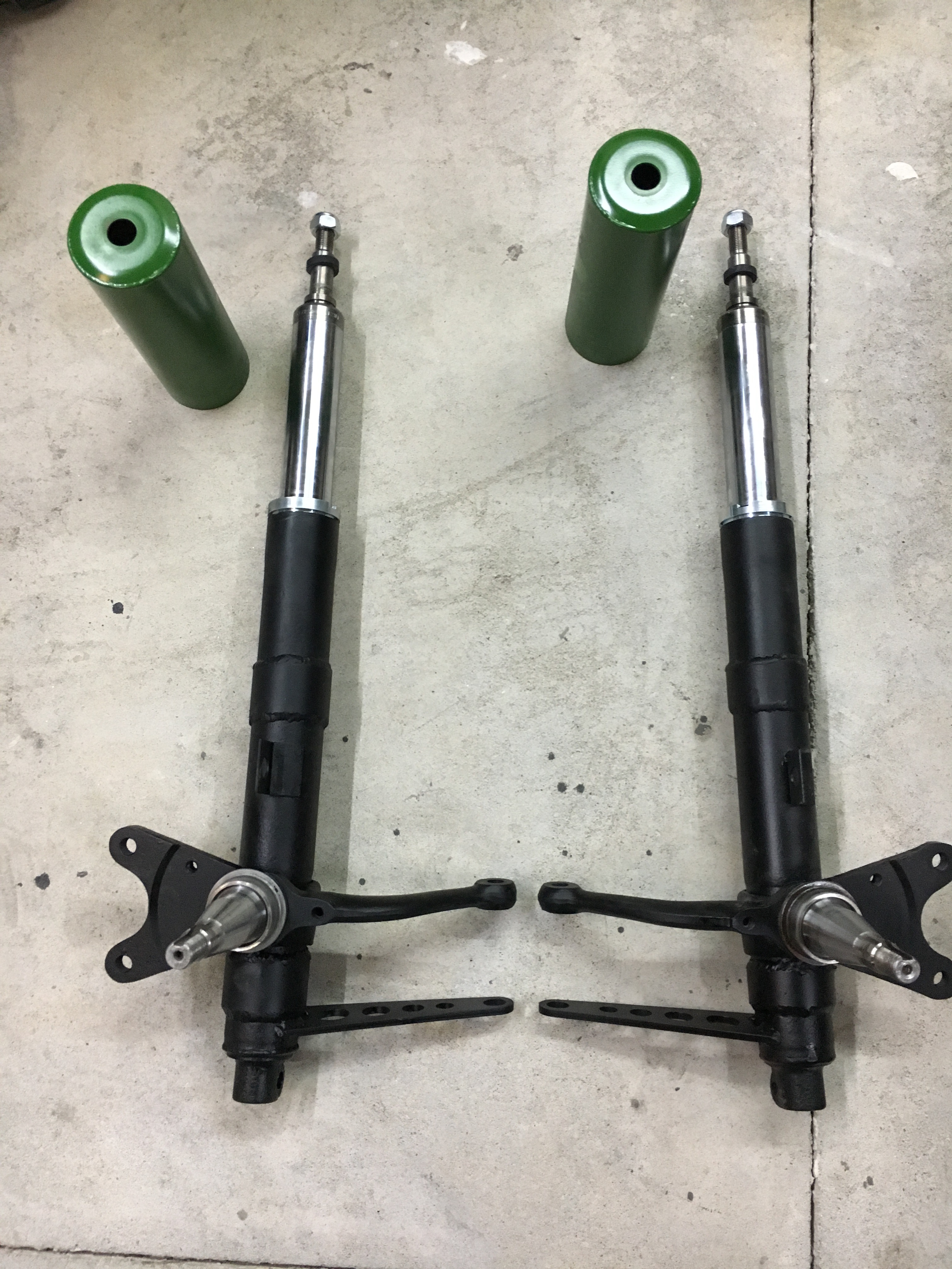

19mm DIY raised spindle 911 struts with Bilstein inserts and double sheer steering arm mounts; installed in place with 911 rotor dust shields in place.
It's notable in this photo the bump steer has not been set and therefore the nuts remain loose. Credits to Rebel Racing for their bump steer kit.
