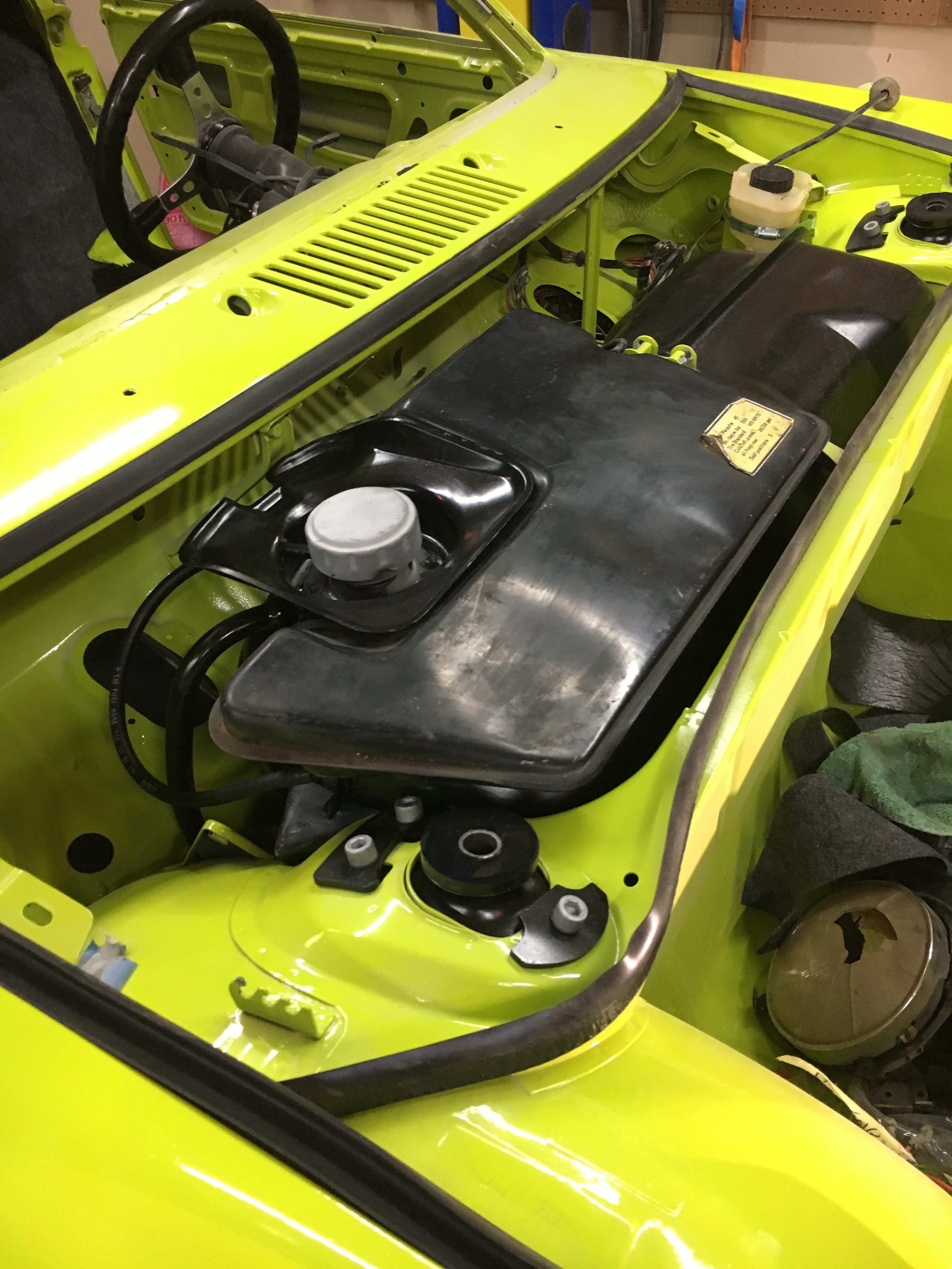

I also managed to get the fuel tank installed with SS fuel lines. This was a PITA.
Also ordered the full rubber seal package from 914 rubber and have started installing a few such as the bulkhead seals here

jmitro   I also managed to get the fuel tank installed with...   Jan 22 2018, 11:42 PM
