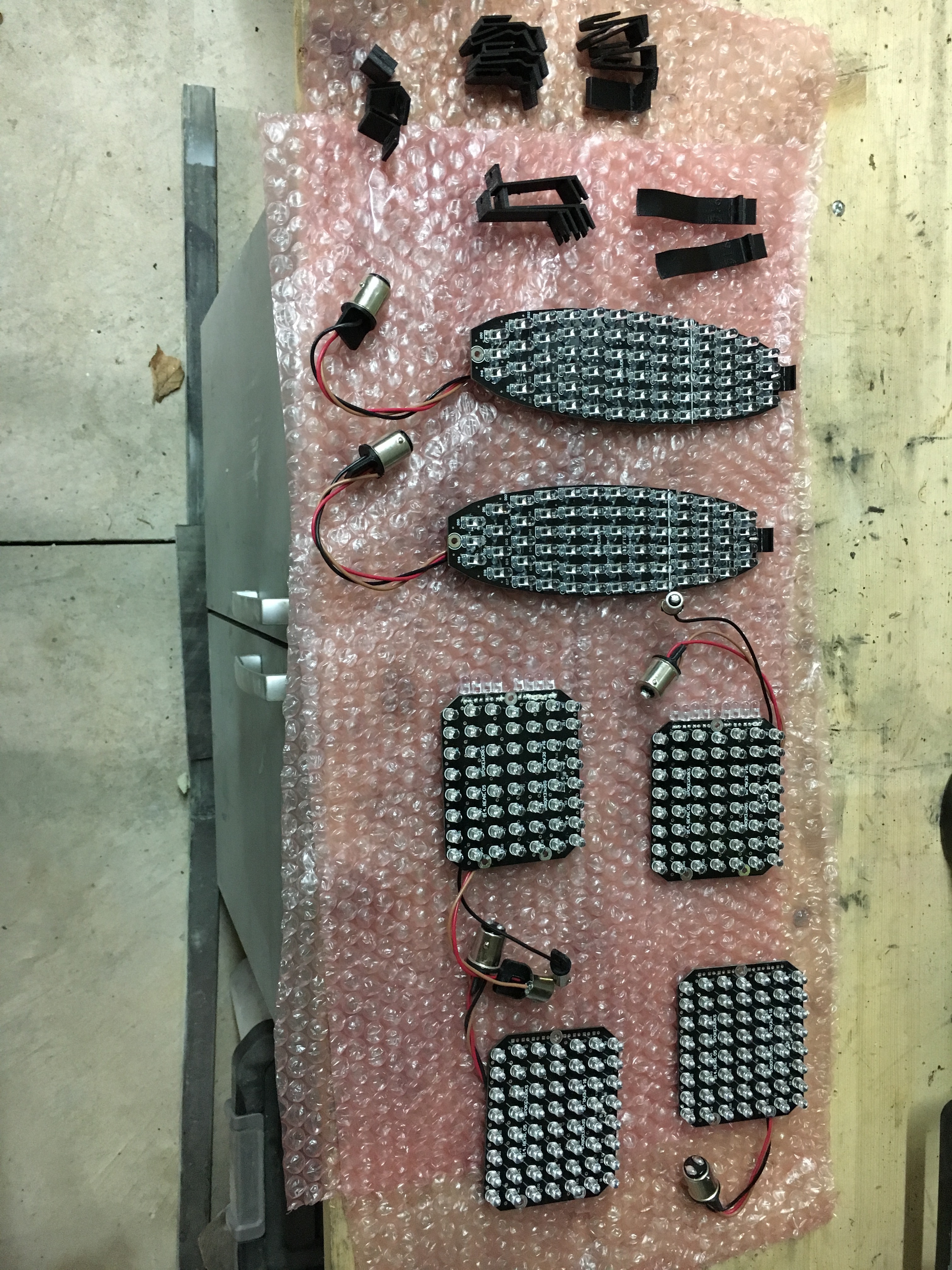

new LED front turn signals, rear turn signals, and rear brake lights from "spoke". I debated about using the original halogen style bulbs and maintaining the car's classic character, but decided that safety and high visibility was justification for altering the original classic character of the car.

jmitro   new LED front turn signals, rear turn signals, and...   Jan 22 2018, 11:44 PM
jmitro   LED tails   Jan 22 2018, 11:45 PM
