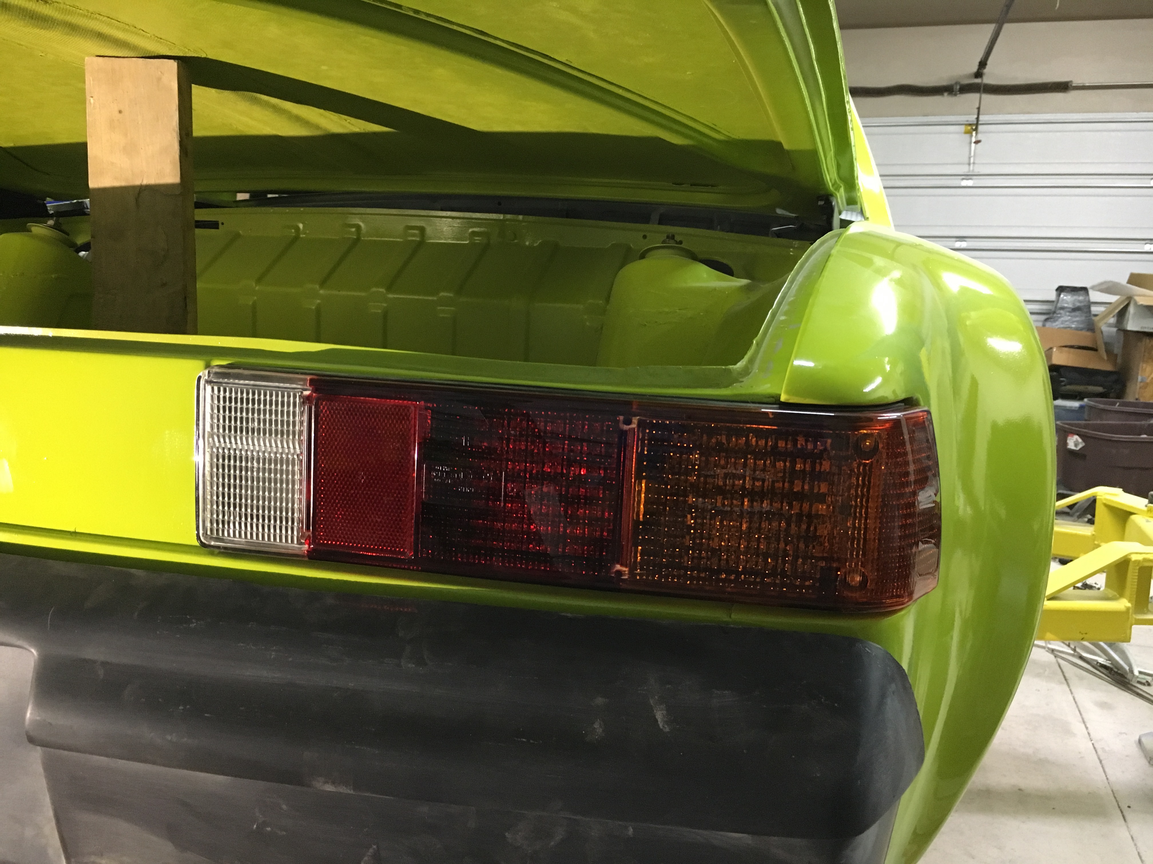

jmitro   new LED front turn signals, rear turn signals, and...   Jan 22 2018, 11:44 PM
jmitro   LED tails   Jan 22 2018, 11:45 PM
