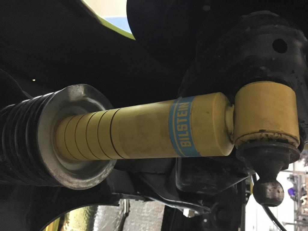

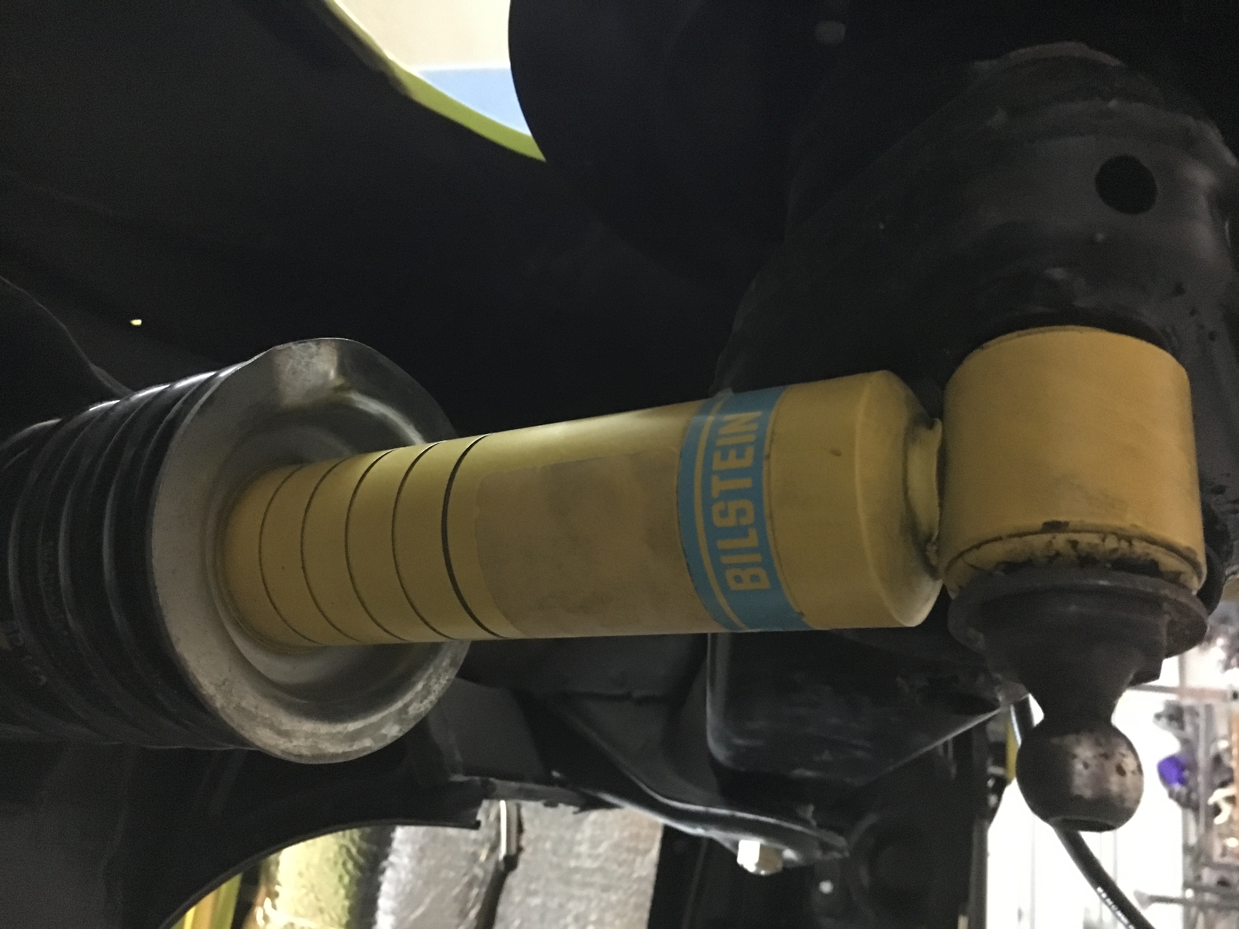

jmitro   19mm DIY raised spindle 911 struts with Bilstein i...   Jan 22 2018, 11:39 PM

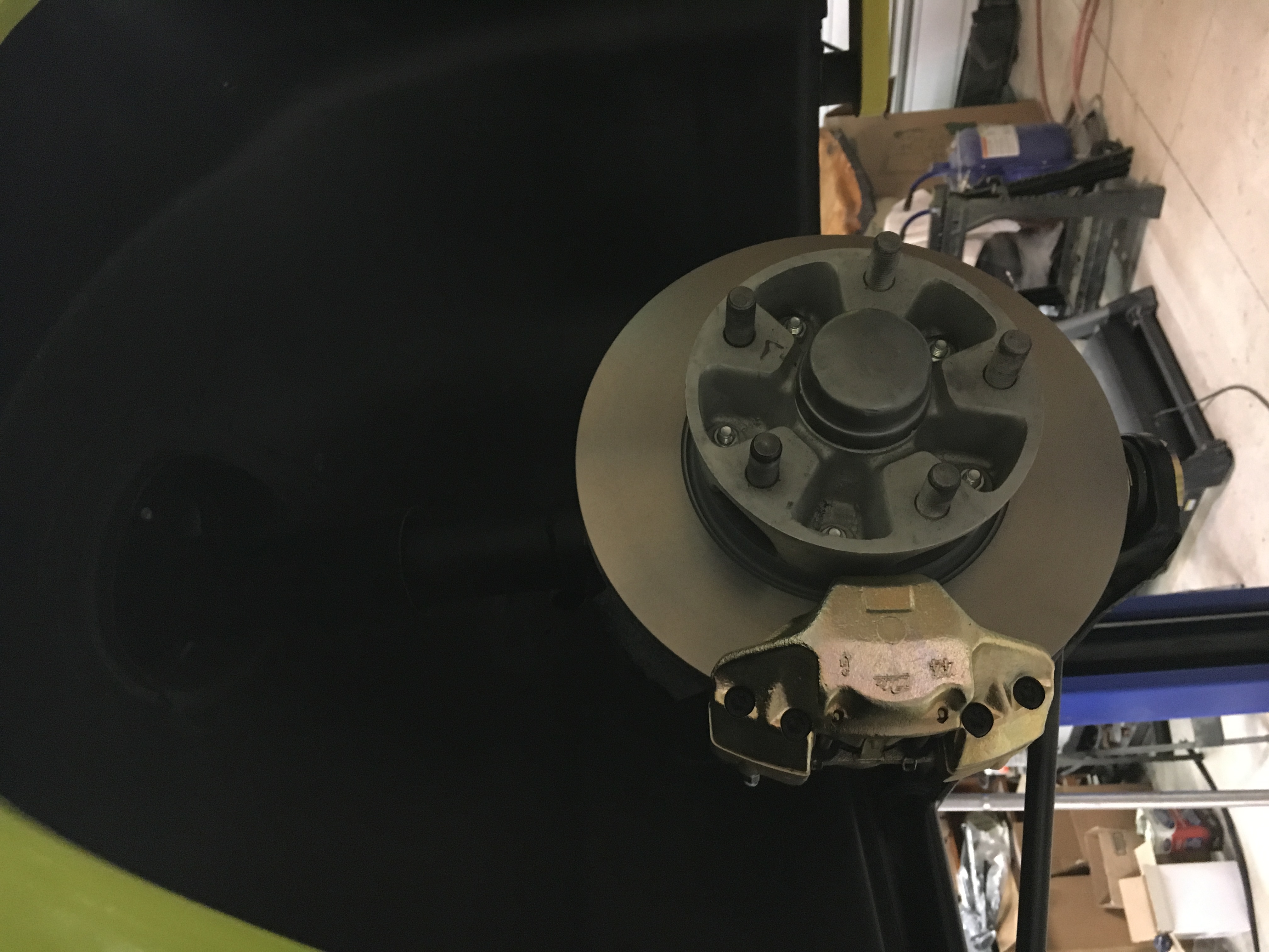

jmitro   Rear brakes   Jan 22 2018, 11:59 PM
