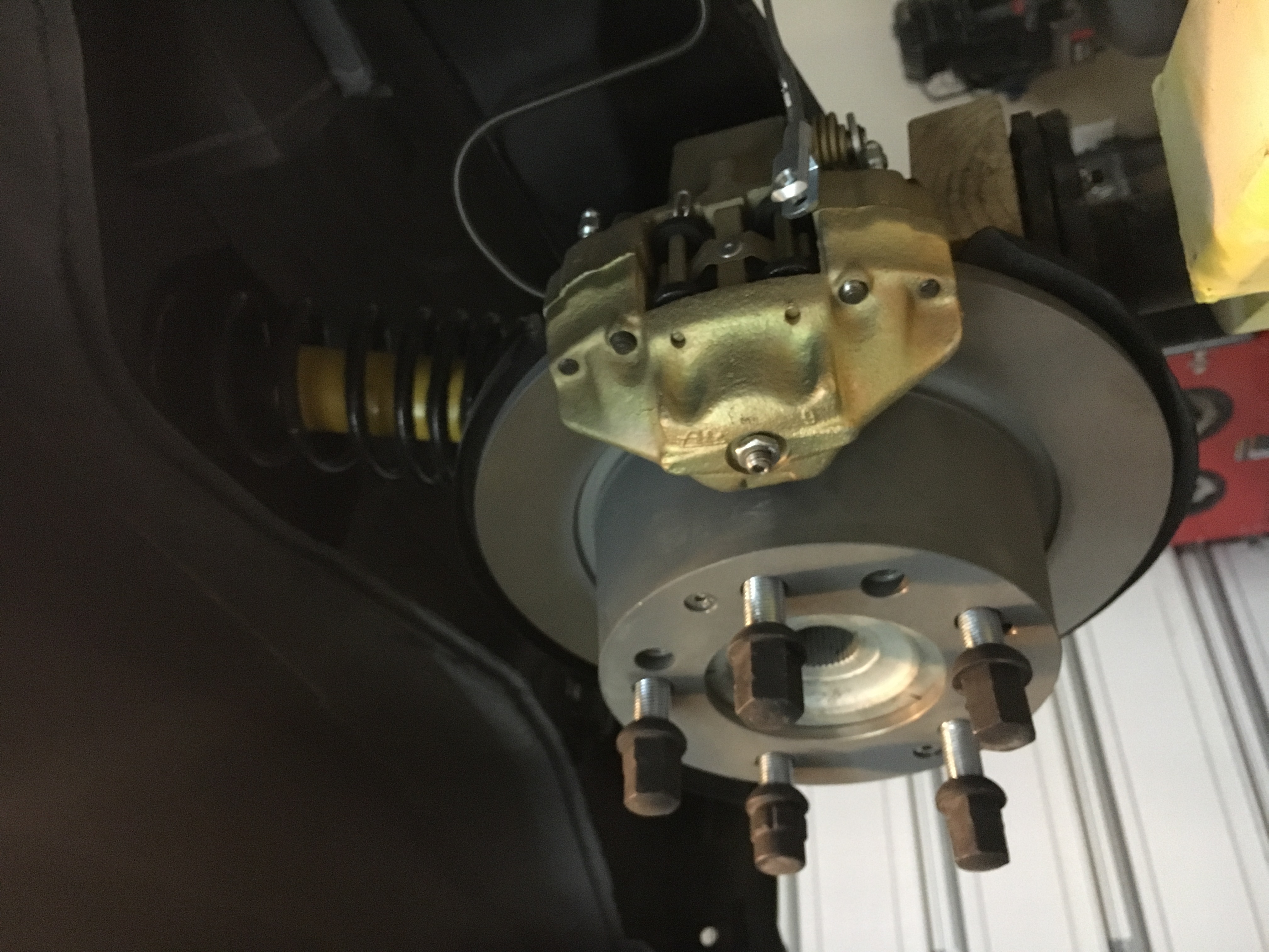

jmitro   The fun part is putting all the new parts back on...   Jan 22 2018, 11:58 PM
jmitro   Rear brakes   Jan 22 2018, 11:59 PM
