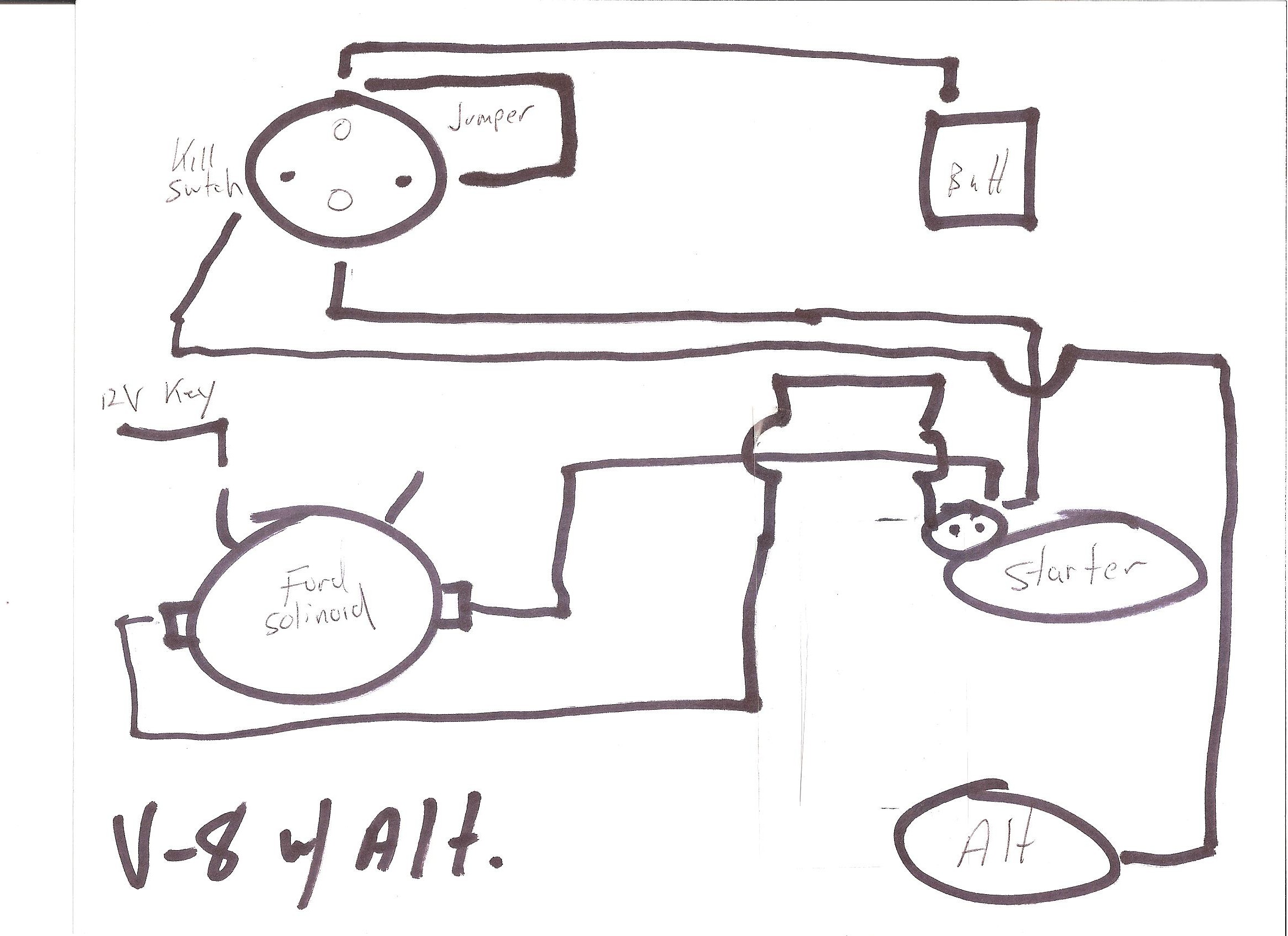

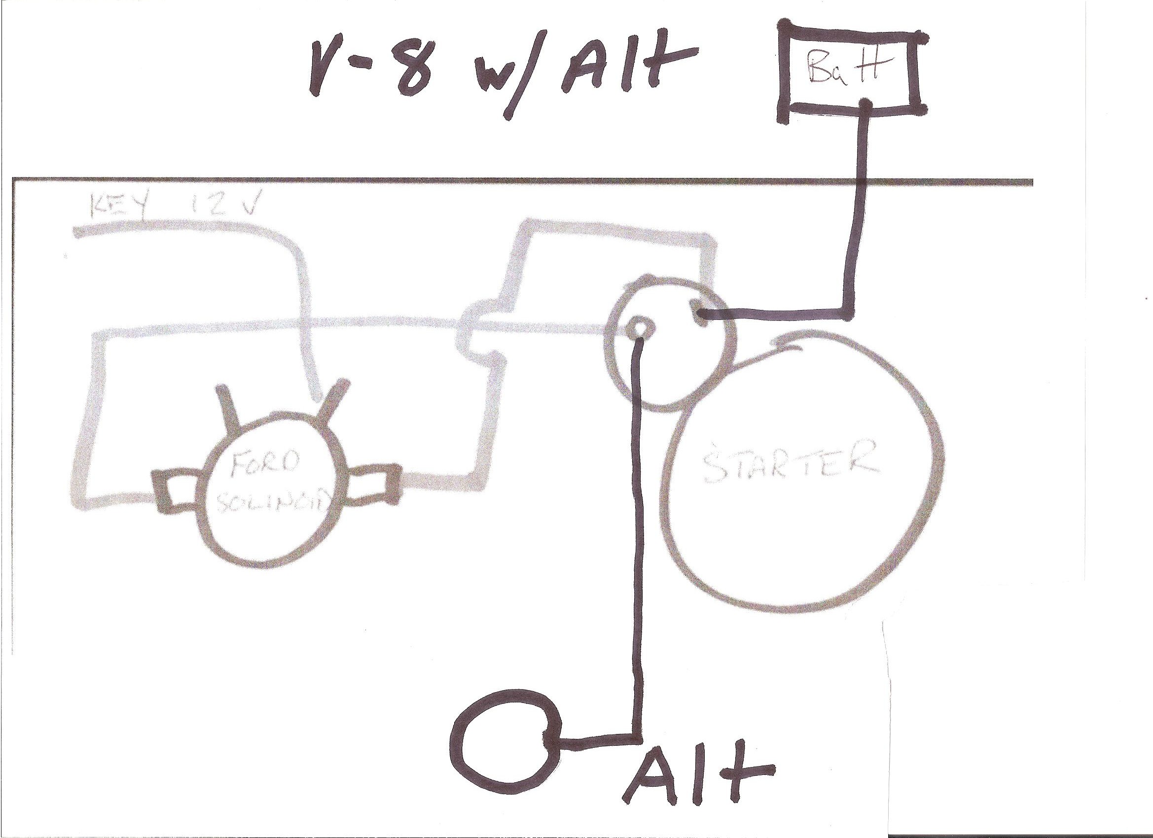

So I've run across a (self created) problem and I wonder if Mark might chime in for a solution?
Previously I had wired in a Ford relay on my sbc converted 914 with a standard alternator per Mark's diagram (an-noted below) as I had been experiencing the well known "hot start" problem.
The fix worked great!
Then I decided to add a track "kill switch" mounted where track workers can get to it in an emergency and therein lies my problem.
When I wire it up per the manufacturer's directions (my diagram below), it works great with one exception...my hot start problem has returned.
Anyone got any idea's?
Marks diagram (an-noted) with no kill switch. Hot start problem solved.
My diagram including addition of a kill switch. Hot start problem returns

Mark Henry   So I've run across a (self created) problem a...   Aug 4 2018, 10:24 AM
HalfMoon   So I've run across a (self created) problem ...   Aug 4 2018, 03:10 PM

Mark Henry   This is how my '67 bug is wired. Also note the...   Aug 4 2018, 10:50 AM
North Coast Jim   Mark I had this "start problem" and foun...   Aug 4 2018, 11:06 AM
Mark Henry   You either still have something wired wrong or you...   Aug 5 2018, 08:04 AM
HalfMoon   You either still have something wired wrong or yo...   Aug 5 2018, 08:14 AM
Mark Henry   I wouldn't worry about the engine running afte...   Aug 13 2018, 05:54 AM
